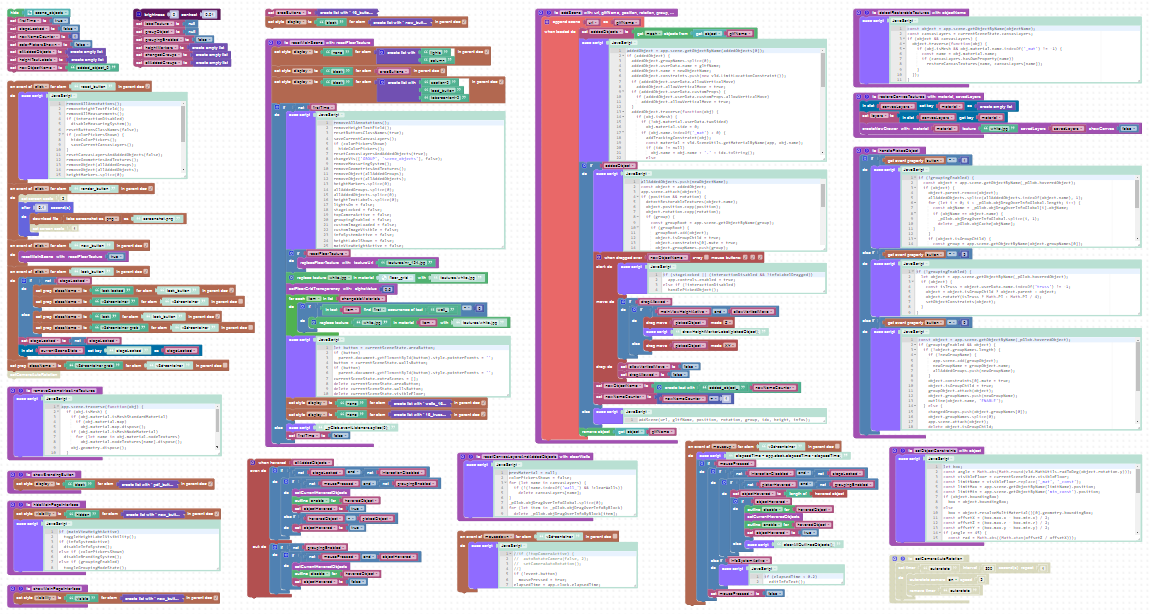

Mixed. Puzzles can’t provide the full access to all needed things in THREE engine.
Mainly it looks this way )))

OK just saw the screenshot you added! :) definitely out of my league for now…
