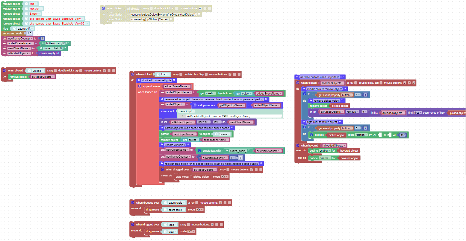

Could u share printscreens of puzzles how did u do it? i ll be rlly thankfull.2022-08-04 at 8:47 am #54624kdvParticipantRemove all trash objects
The initial settings
Append a new scene and register the drag action for all added objects
Manipulate all added objects

One more thing: the last two blocks of puzzles must be located after all other
when clicked
blocks. Otherwise dragging of the added objects will not work ))) Place otherwhen clicked
listeners on the right and higher of these two blocks like on the attached screenshot. And you should add all objects that are supposed to be moved into theallAddedObjects
list.Attachments:
