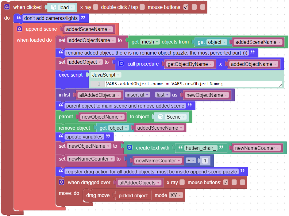

append scenepuzzle. Disable it.The main problem is that you can choose objects only by their names but the names of chairs are the same. So, the engine looks for the specified name and finds one object that was added first )))
You should rename the appended scene first. Use the
alias nameoption in theappend scenepuzzle and a variable, that will change this alias name after every appending. That will give you the possibility to remove the appended scenes separatly. Then you should change names of added objects after scene appending. That requires some scripting…Is that what you wanted?

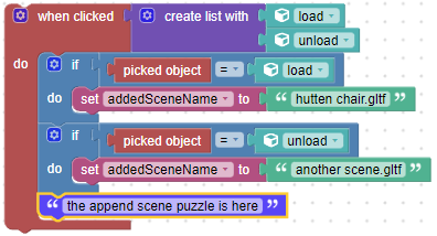

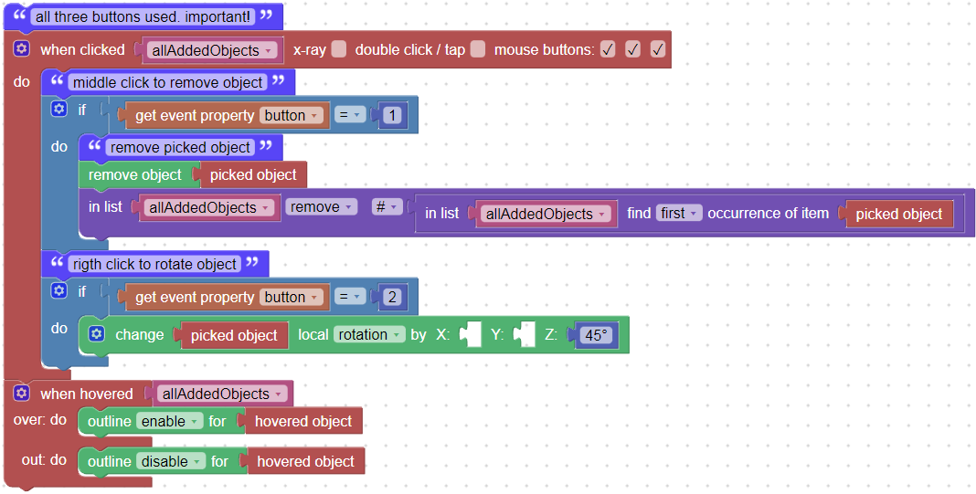

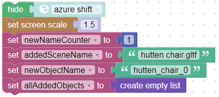

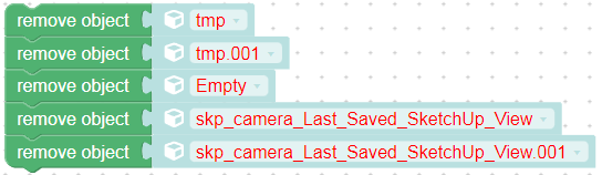

ParticipantRemove all trash objects
The initial settings
Append a new scene and register the drag action for all added objects
Manipulate all added objects

One more thing: the last two blocks of puzzles must be located after all other
when clickedblocks. Otherwise dragging of the added objects will not work ))) Place otherwhen clickedlisteners on the right and higher of these two blocks like on the attached screenshot. And you should add all objects that are supposed to be moved into theallAddedObjectslist.Attachments:

https://v3d.net/9hm2022-08-06 at 1:28 pm #54675kdv
Participantso do i need to create all completly new set of variables for each new object ?
Nope. just use what you have, with some changes.
First, change the initial settings
remove this
and change this
then change thewhen clickedpuzzle
and then change one puzzle in theappend scenepuzzle
That’s all. You can just change scene names to append other objectsand how does variables creating works

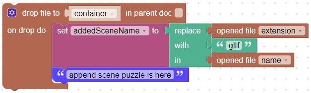

Let’s suppose this menu contains some pictures and these pictures have names that are similar to .gltf scenes. hutten chair.jpg corresponds to hutten chair.gltf. Right?
Then just grab some picture from the menu and drop it into the scene. And use thedrop filepuzzle to get the name of a scene that must be loaded
In any case, whatever method you choose (clicking an html element or dropping a file/picture), the main action is to detect and assign the name of the scene that you want to append.
