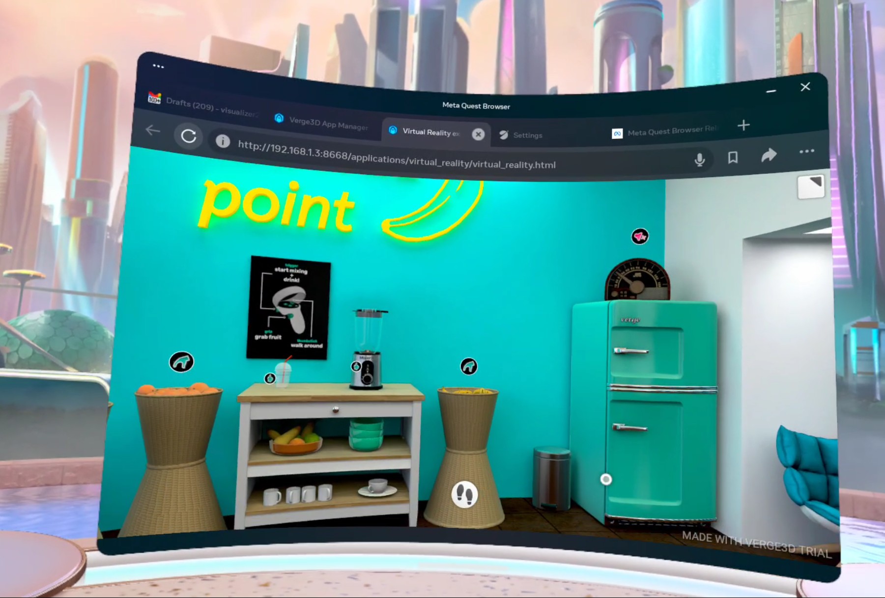

here is what I see in my Quest for the app manager example. Enter VR button disappeared againdo I have to upgrade to 4.6? OR just some settings to recheck?
2024-05-05 at 10:50 am #72629kdv
ParticipantMan, you simply connected to the external IP adress http://192.168.1.3:8668 instead of required http://localhost:8668 It won’t work this way. Nothing surprising.
Enable port forvarding on PC and open http://localhost:8668 in the MetaBrowser
Which of words in this sentence you didn’t understand?
