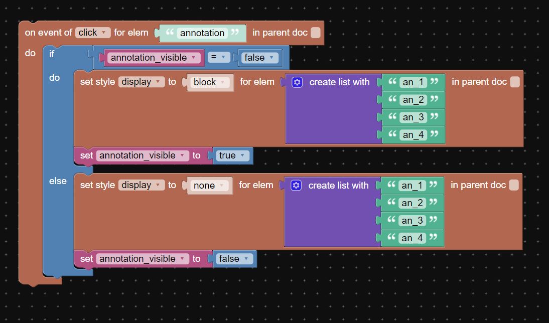

ParticipantHi,
Please download the sample AR project demonstrating the issue.
Click the “i” icon in bottom right corner to toggle annotation.
But right now the annotations are not working when “i” is pressed.Link: https://drive.google.com/file/d/17oEm4lsTaVM3GZuR0_dnfd8JdHyCrmxh/view?usp=sharing

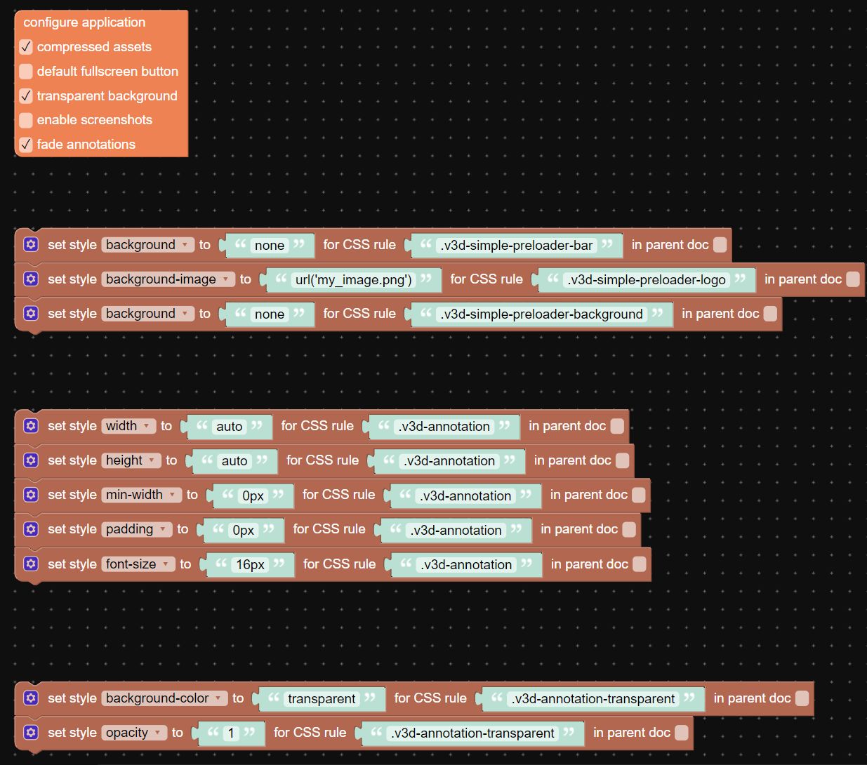

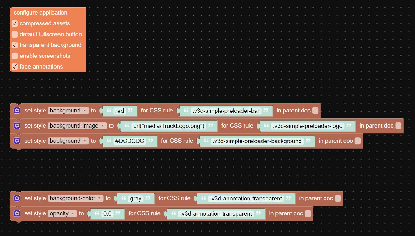

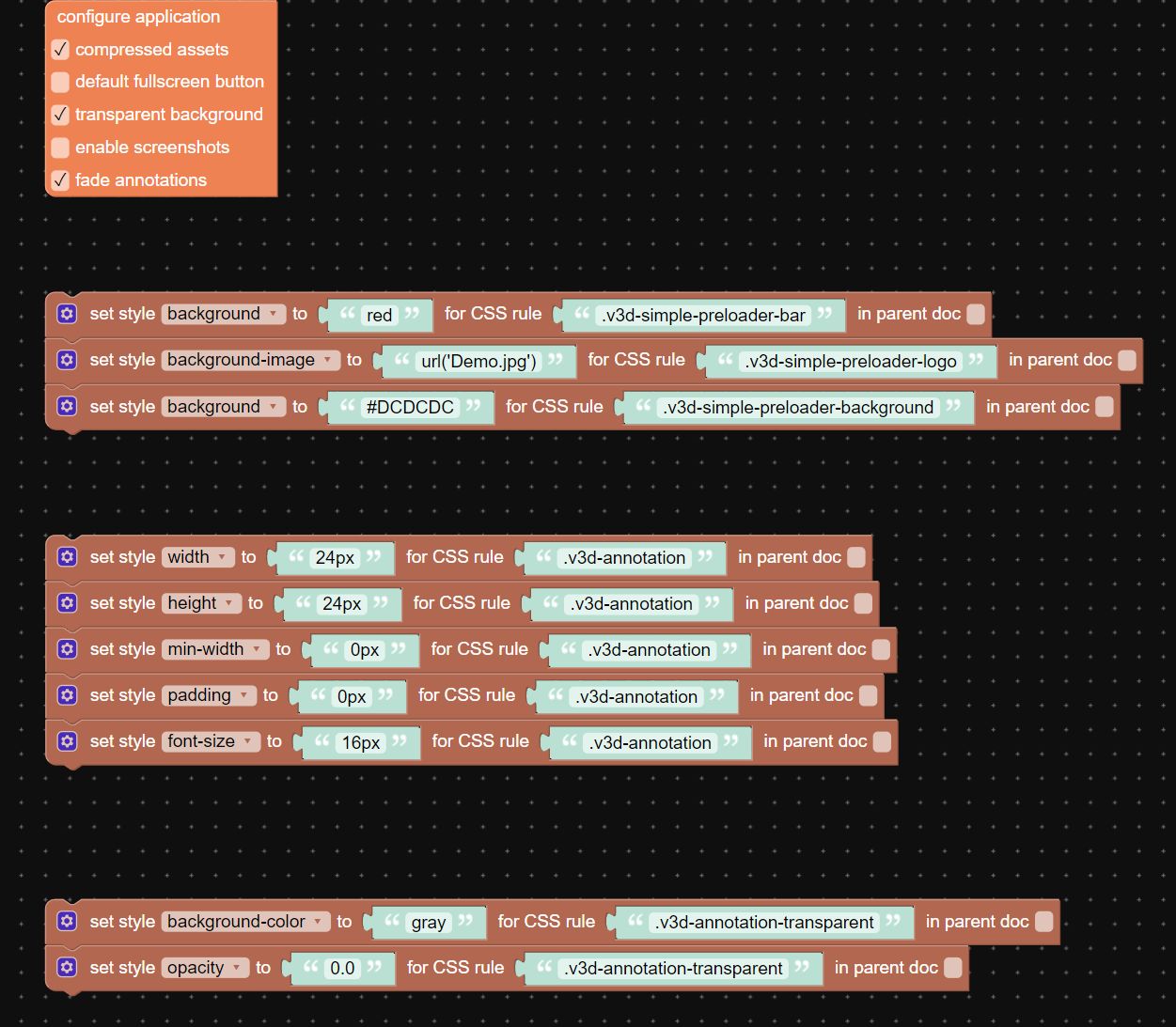

Also I have noticed another issue in Verge3D 4.6.0, when saving and loading the puzzels.
I created css styles in the Init tab and saved it.
But upon closing the puzzle editor and reopening it, all the values that I have set for the css styles are replace with the default ones.
Please check the images named saved.jpg and LostValues.jpgKindly help me to resolve these issues. Thanks

2024-04-28 at 2:36 pm #72540kdv
ParticipantAlso I have noticed another issue in Verge3D 4.6.0, when saving and loading the puzzels.
Actually, you could notice this issue right after they introduced those new CSS style puzzles.
set style for elemworks properly,set style for CSS ruleresets to default values. For now, to bypass the problem, use text puzzles instead of the shadow blocks.Puzzles and JS coding. Fast and expensive.

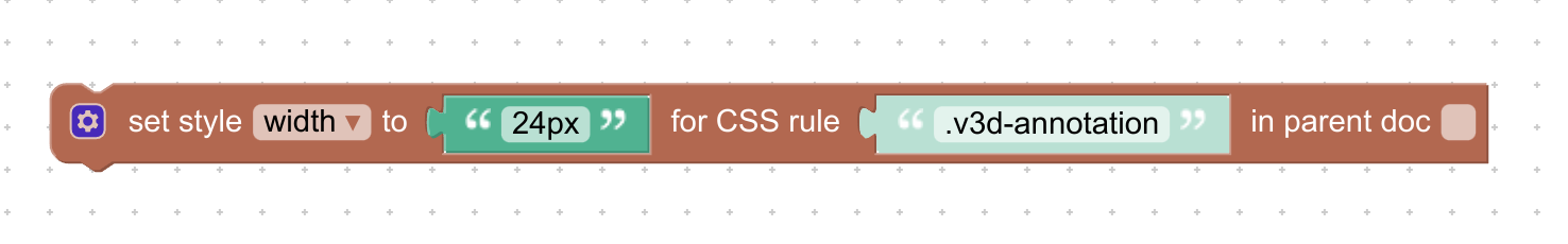

Alexander KovelenovStaffHi,
Thanks for the example app. This is kinda serious bug which we’ll fix in the upcoming preview build v. 4.7 (can be expected on the next week). Meanwhile you can use the workaround suggested by KDV or text inputs to the “set style … css” inputs:
Regarding annotations in AR work, they should work as usual, provided you specify “allow html” in “enter AR mode” puzzle.
