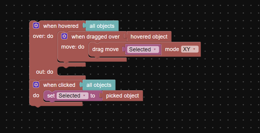

2023-04-04 at 12:57 pm #61673Gelo29
Participant2023-04-04 at 5:59 pm #61699kdv

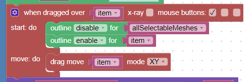

Participantwhen hoveredpuzzle is a little useless on sensor devices. And your logic registereswhen dragged overlistener every time the object is hovered…

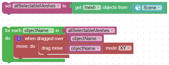

2023-04-05 at 7:12 am #61734kdv
ParticipantOne more way (and more correct) to register dragging for all meshes existing in the scene

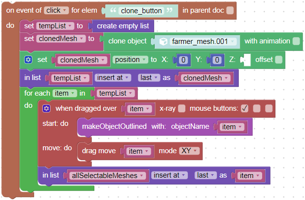

2023-04-05 at 12:12 pm #61754Gelo29
ParticipantI can’t make it work, Because we are cloning the objects. And I think there is a delay and it doesn’t work now on PC. I will try to send the puzzles.
2023-04-05 at 1:01 pm #61755Gelo29
ParticipantI think the issue now is that We can’t drag any newly added object using Clone or Append.

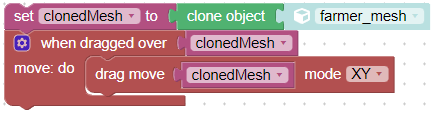

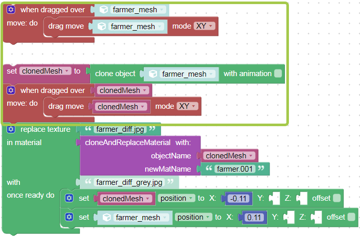

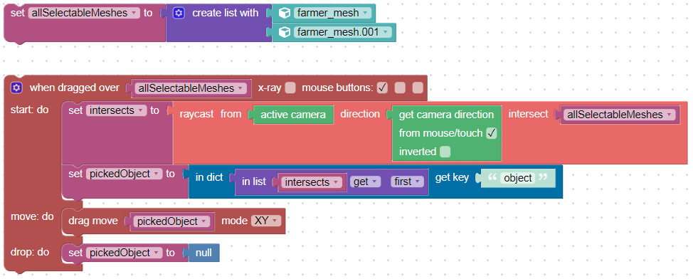

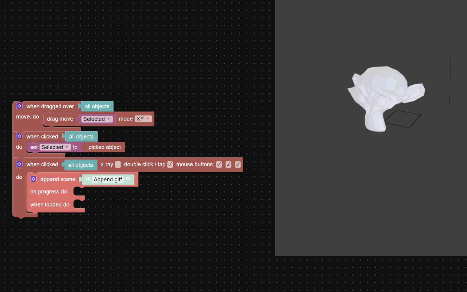

2023-04-05 at 9:09 pm #61775kdv
Participantwhen dragged overpuzzle is a function that just registers an event listener for selected (and already existing in the scene) objects. Dragging for cloned objects should be registered this way
The
when clickedpuzzle is useless on sensor devices for detecting an object for dragging. It will work on the “touch end” event (when dragging actions is already over). Or you will need to touch the object first, then touch it again and drag.And you’d better not use the
all objectspuzzle at all. This puzzle returns ALL existing objects in the scene: empty objects, lights, meshes, bones, reflection probes, etc. at the moment it was called.That’s how it works with cloned objects
Making objects from appended scenes draggable/clickable is a little more complicated story but it’s also quite possible.
One very important thing: all objects supossed to be dragged/clicked/hovered MUST have unique names. If you append three scenes with the monkey only one of them will be interactive (the first one). You should change meshes’ names after appending.
https://v3d.net/i2l
(double click in any place to append a new farmer)Puzzles and JS coding. Fast and expensive.

2023-04-12 at 8:08 am #62007kdv
ParticipantBut we need the Click event to register a Active object
No, you don’t.
when dragged overuses its own raycaster to detect selected objects.Moreover,
when dragged overcan be used instead ofwhen clicked
https://v3d.net/i2lPuzzles and JS coding. Fast and expensive.
2023-04-13 at 8:34 am #62043Gelo29
ParticipantI see that your puzzle it cloned the object on first load, What if you cloned it thru event then add that to a Variable called “ClonedList”. That is the problem I’m still getting. It’s not considering the newly cloned object to the scene for when dragger over.
2023-04-13 at 10:06 am #62044kdv
ParticipantWhat if you cloned it thru event then add that to a Variable called “ClonedList”
There is one important workaround: the variable
clonedMeshis global and changing after every cloning, so it shouldn’t be used inside thewhen dragged overpuzzle if you clone more than one object using the same variable.Puzzles and JS coding. Fast and expensive.

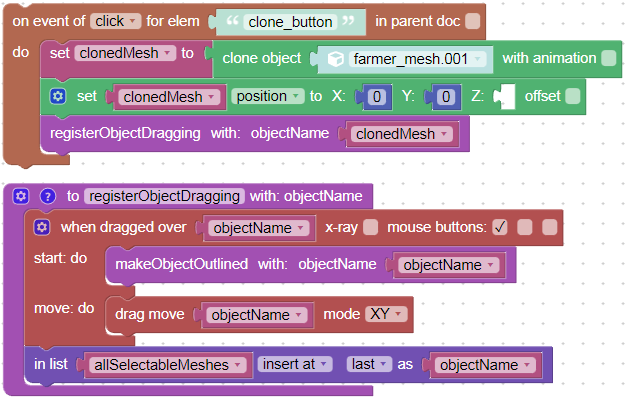

2023-04-17 at 11:32 am #62121kdv
ParticipantOne more way (and more correct) to register dragging for cloned meshes

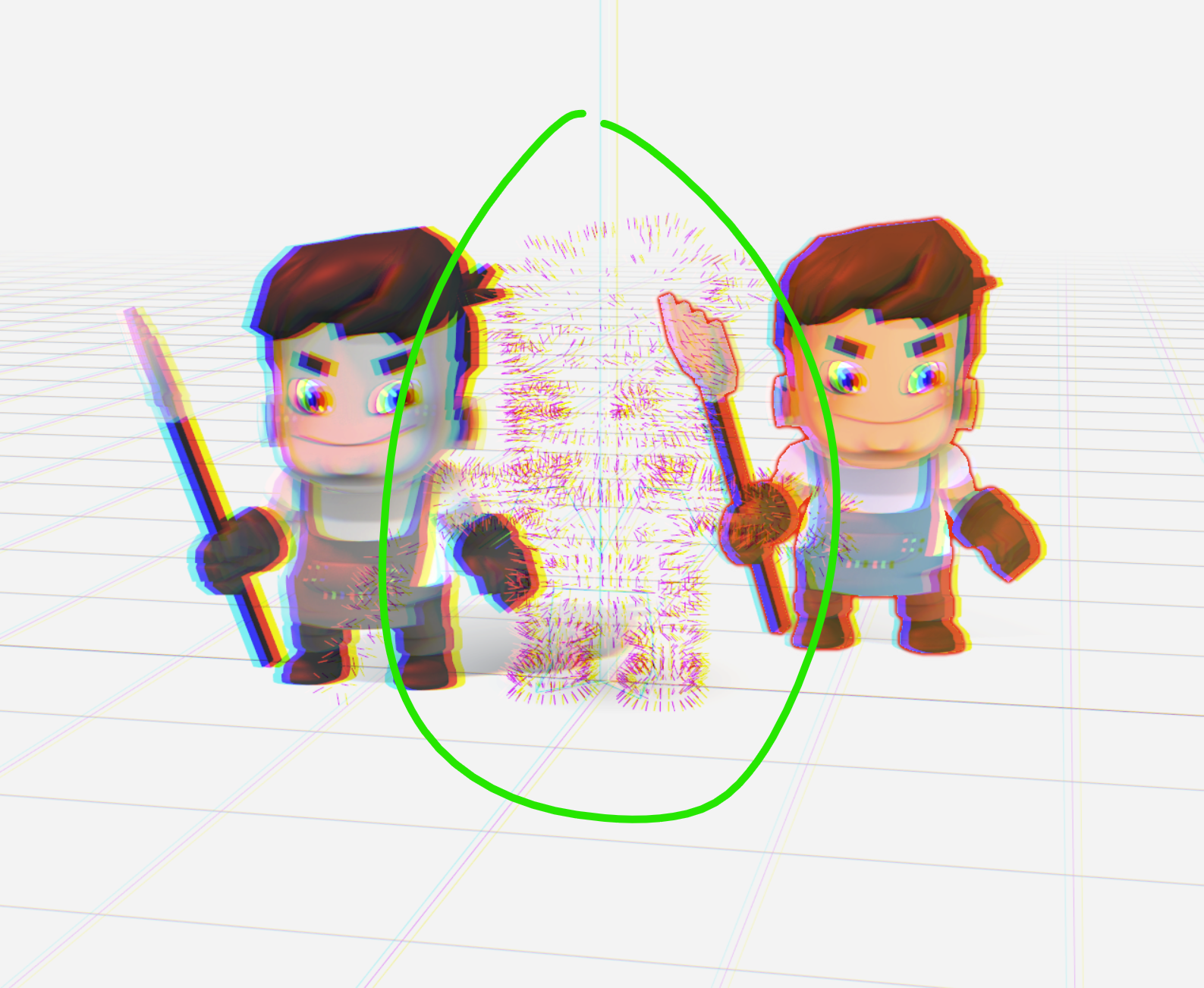

2023-05-02 at 8:53 am #63390Gelo29
ParticipantHello, I saw the link on your sample. What are these spikes?
This is the link you sent here:
