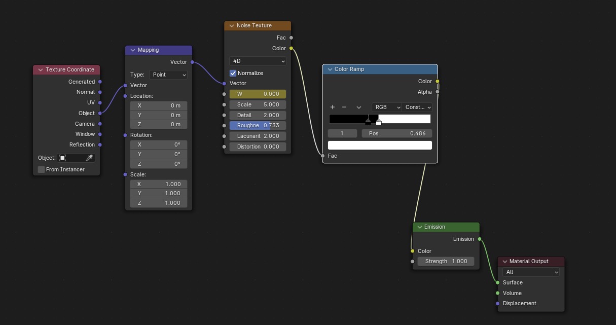

    Could you please help me find information on how to deal with animated procedural material? I can animate my material in Blender, but when I export my model via Sneak Peek, it doesn’t work. I can animate the position of the object but not its material. I’ve attached my nodes configuration.

    Add the Value node, connect to W, animate this Value node. In materials only Value nodes can be animated to work in Verge3D.

    I’ve added a Value node, but it hasn’t helped.

    4D is not supported.
    https://www.soft8soft.com/docs/manual/en/blender/Shader-Nodes-Reference.html#Noise_Texture
