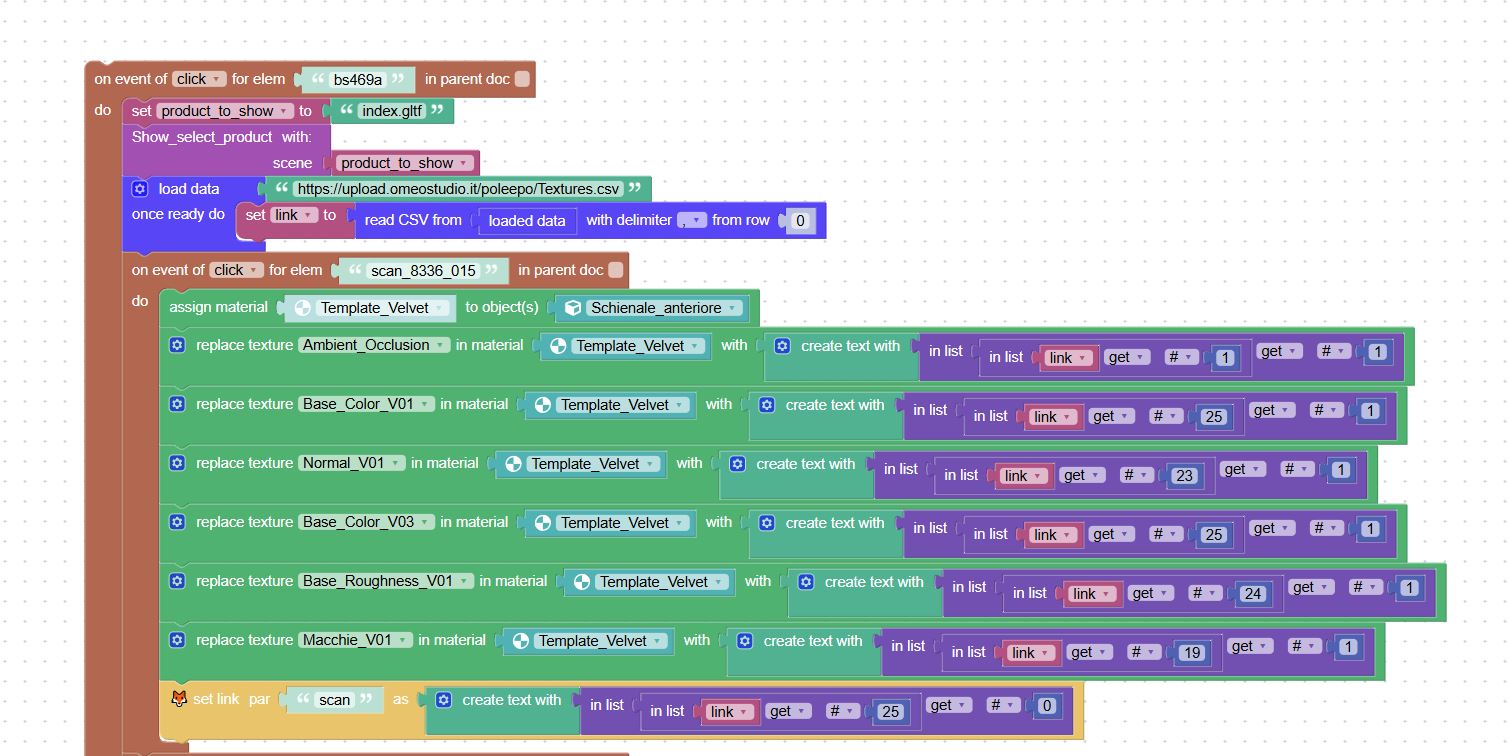

    Show your puzzles. Or better attach your app here (in zip).

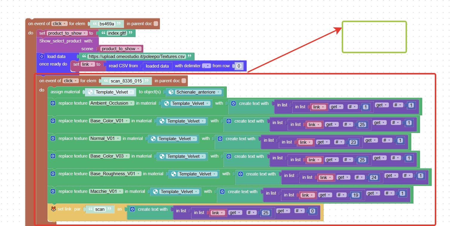

    Every time you click on bs469a you create an event listener for scan_8336_015. Clicked three times – three event listeners created. Then you click on scan_8336_015 and all three event listeners will be triggered. As a result, you click one time but you puzzles will perform actions three times.

    Look at the screenshot above and move the selected set of puzzles outside as shown.
