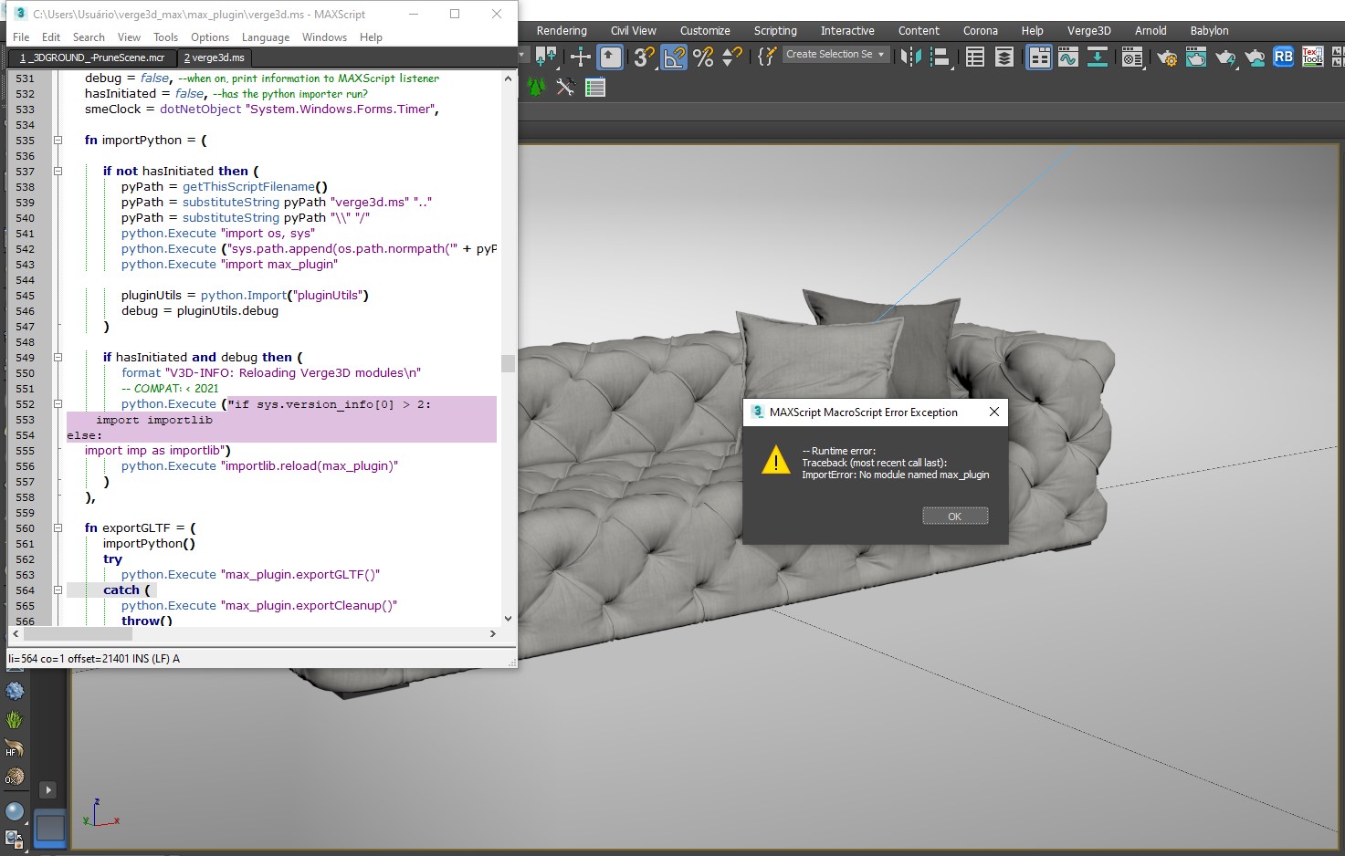

    Subject: problem when running the functions in 3dsmax
    I’m having problem when executing the actions of verge3d. the following error appears
    Maxscript macroscript error esception
    –runtime error:
    traceback (most recent call last ) ;
    import error : no module named max_plugin
    how do I solve this?

    What version of Verge3D and 3ds Max you have installed? Please try steps from this guide to resolve your issue.

    the 3dsmax version I’m using is 2020, and the 3d verge is 3.7.1.
    already uninstalled verge and installed it again and gave the same error, I also installed the new version 3.8 to test and gave the same error.
    and the installation directory I’m keeping the default C:\Users\User\verge3d_max
    #42935
    It’s possible that this happens because your user name contains international characters. Please try another path, such as C:\verge3d_max or switch to more recent 3ds Max version (i18n characters work without issues in Max 2021+).
