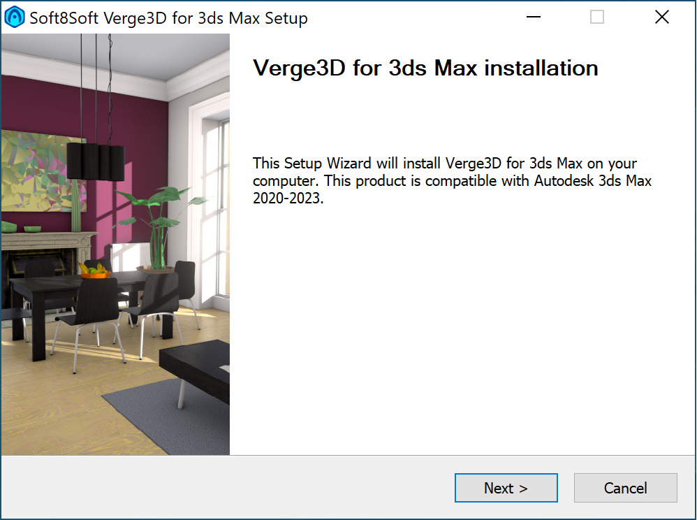

Verge3D Installer
Download the Verge3D bundle and double click on the .exe file to run the installer.

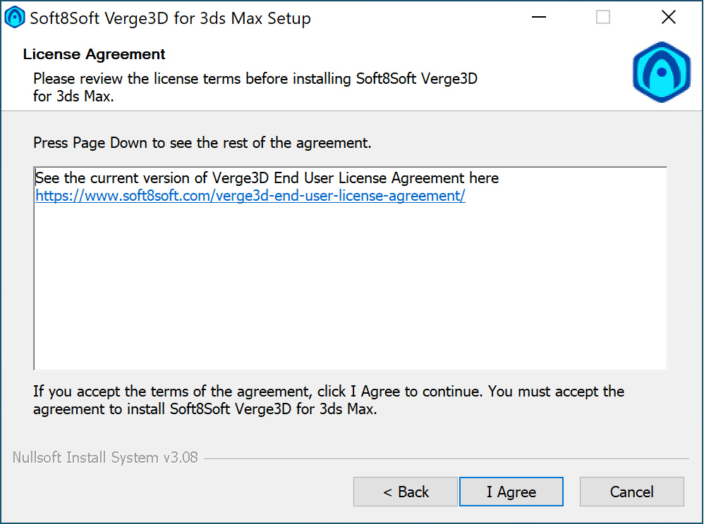

Follow the link to read the recent version of Verge3D license agreement.

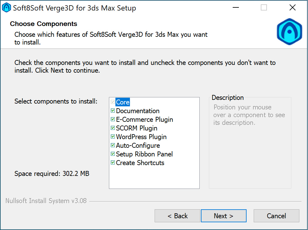

Choose components you want to install.

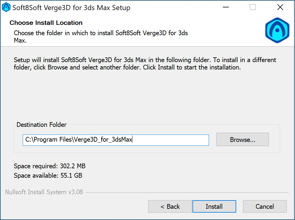

Choose an installation folder that have enough permissions for reading and writing (or better leave it by default).

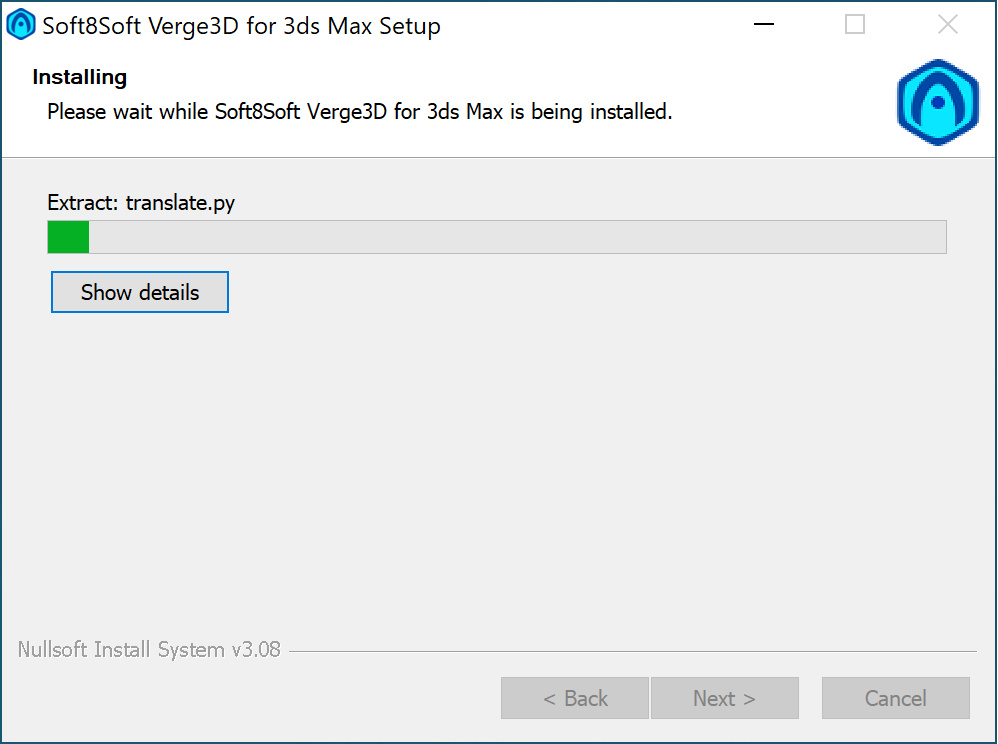

Wait until the installer finishes copying files to the target directory.
Once installation complete you'll see the following screen.

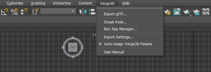

Now you may open 3ds Max. If you had it running, be sure to close and open it again. You should see Verge3D menu in the main menu bar.

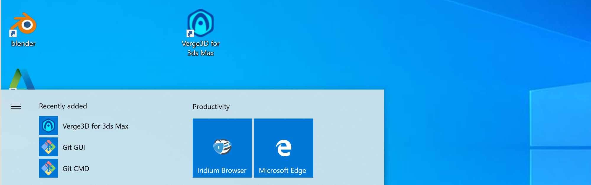

You may also launch the App Manager without running 3ds Max by clicking on the desktop icon or using the Start menu.

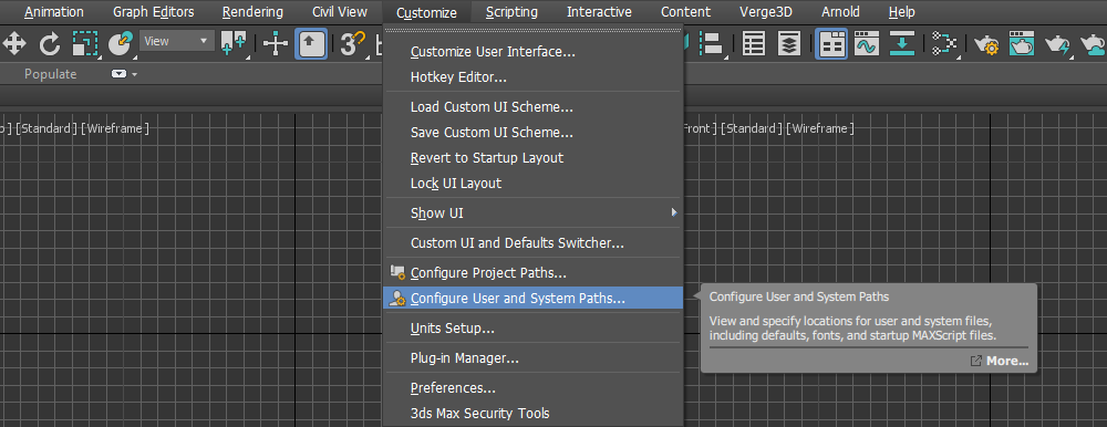

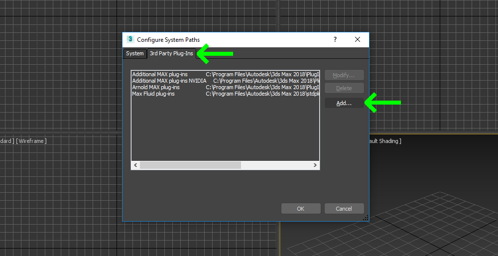

Run 3ds Max, and select "Configure User and System Paths..." under "Customize" in the main menu bar.

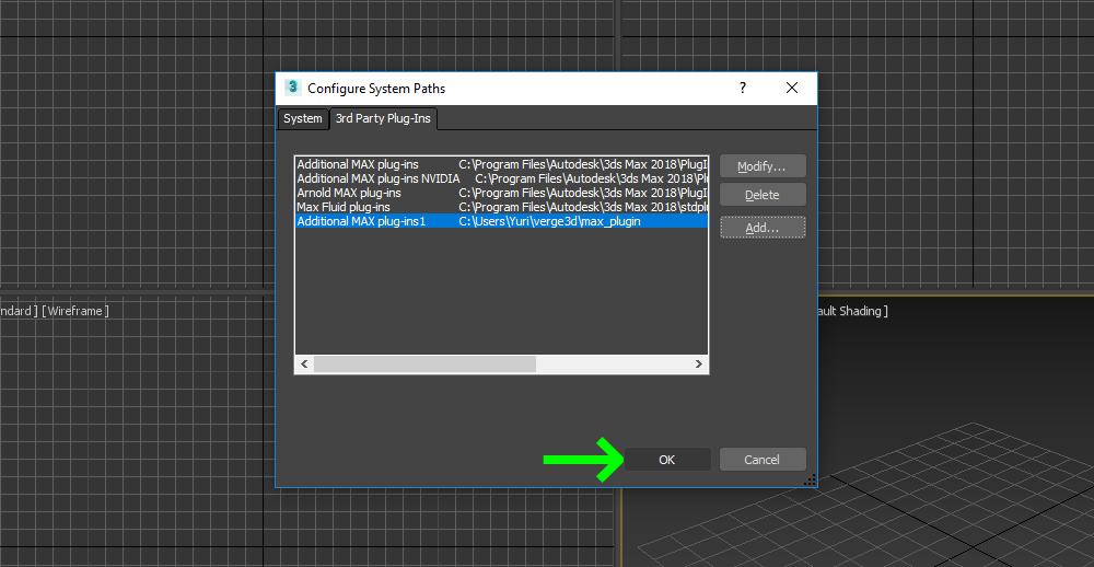

Switch to the "3rd Party Plug-ins" tab and click the "Add..." button.

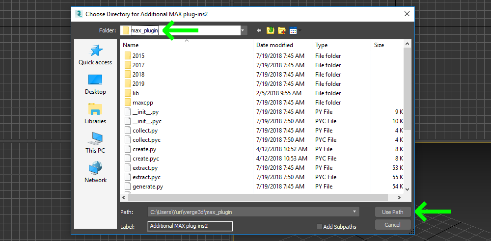

Navigate to the folder in which Verge3D is installed and then to the "max_plugin" folder inside it. Click "Use Path".
Click "OK" and re-open 3ds Max.

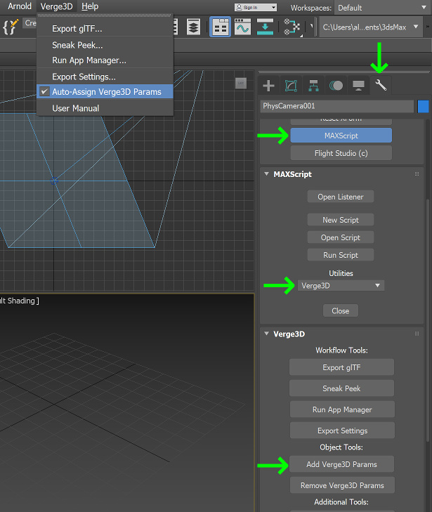

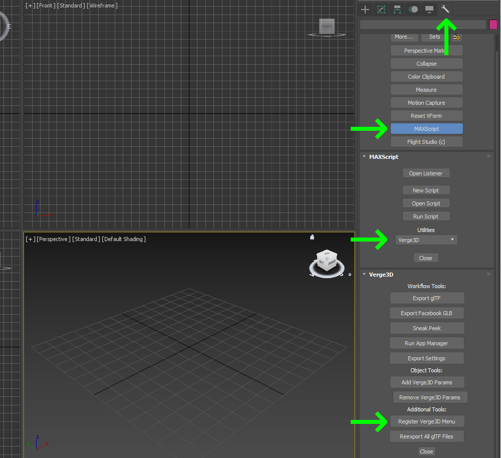

In some rare cases, the Verge3D menu may not show up in the main menu bar even if you configured the plugin path and re-opened 3ds Max. To register the menu manually, go to Utilities, click MaxScript and select Verge3D in the dropdown menu. Then click Register Verge3D menu.
Verge3D Properties on Objects are Missing
Custom Verge3D-specific properties are added automatically to objects upon their creation if Verge3D → Auto-Assign Verge3D Params is enabled. Verge3D params are not created though in the cases when you import a scene, open a file which was created before Verge3D was installed, or if the above-mentioned option is switched off.
Either way, you can add Verge3D settings to existing objects manually, by going to the Utilities tab, selecting Verge3D under MAXScript and clicking Add Verge3D Params for selected objects.

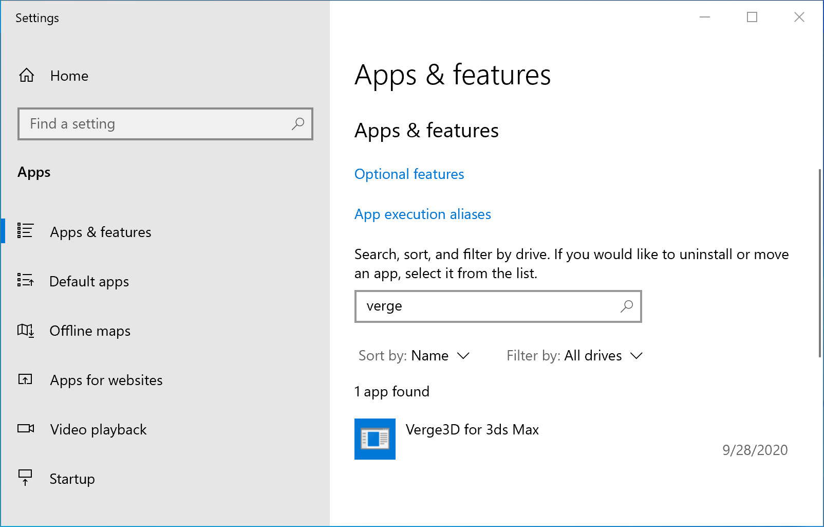

In order to remove Verge3D files, as well as the desktop icon and the Start menu entry, from your computer, you may use the standard Add or remove programs function of Windows. It won't touch the applications and puzzles folders where user files are stored, so you may remove them manually if you don't need them anymore.

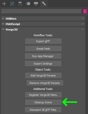

Before you uninstall Verge3D, you might need to remove custom Verge3D options assigned to your objects. To do so, go to Utilities, click MaxScript and select Verge3D in the dropdown menu. Then click on the Cleanup Scene button.
Alternatively, there is a cleanup script which you can drag-and-drop to an opened 3ds Max scene to perform the same task. This option does not require you to have Verge3D installed.
