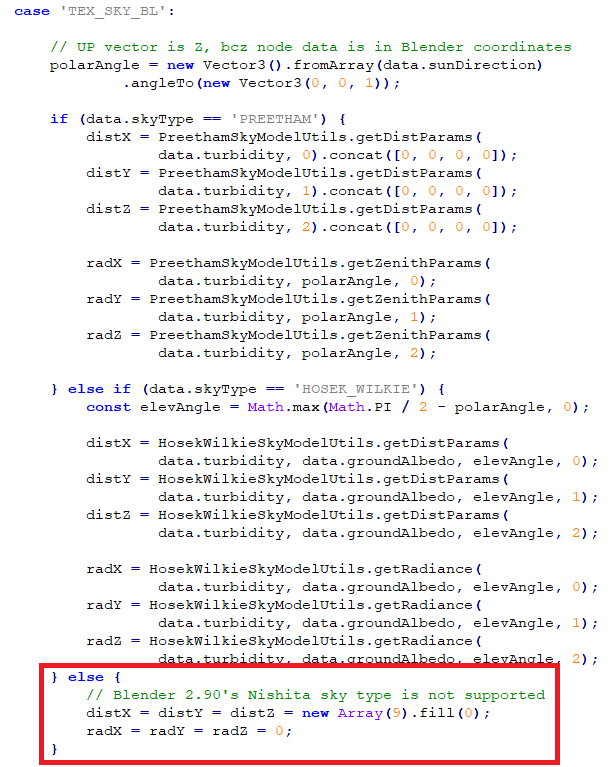

    Blender’s Nishita sky type is only partially supported in EEVEE and not supported at all in Verge3D. Just forget about Cycles and its features when modelling for WebGL…

    We just supported Nishita sky model in in Verge3D 4.11. Feel free to check it out!
