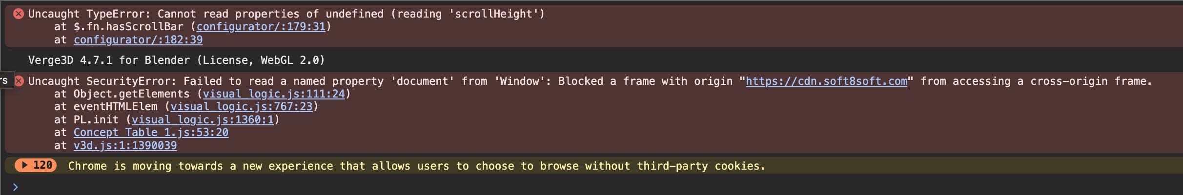

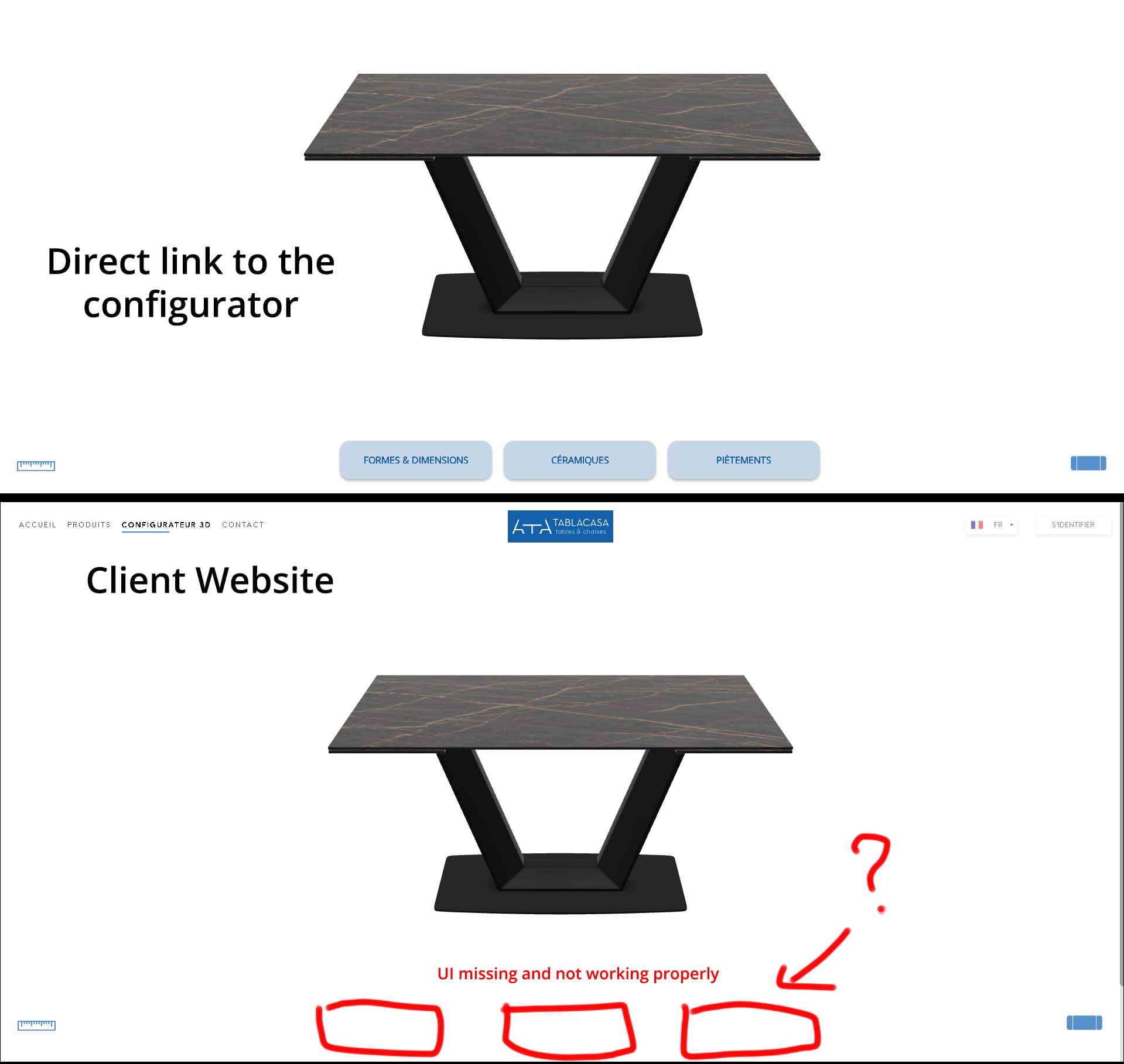

    Hi, I made a table configurator using puzzles. It works fine, except on my client’s website. The HTML interface isn’t working there. I’m stressed because it’s an important client. Any help is appreciated!
    this is the link to my client website configutator : https://www.tablacasa.com/configurator/
    this is the link to the 3D configurator : https://v3d.net/13qe
    I think the main issue is me (lol) but I’m so bad at coding that I had to make it using puzzles.
    Thanks in advance for you help !
    #78499
    I would recommend opening the Developer Tools in chrome and looking at your client site. You will see some errors that will lead you to the solution more than likely.
    #78501
    Hi Nathan,
    It looks you encountered the cross-origin issue. See this topic for possible solutions.
    #78503
    if you upload your app to the client’s server the problem will be gone.
