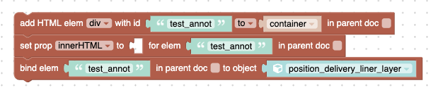

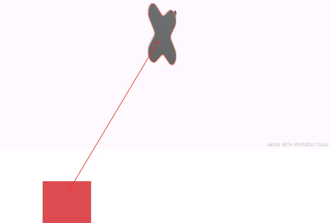

    I have an HTML element(an image exported from webflow) that I want to bind to an object(empty), but it’s not sticking to the object and moving outside the frame. Is there a way I can use ‘Set Prop’ to achieve this?

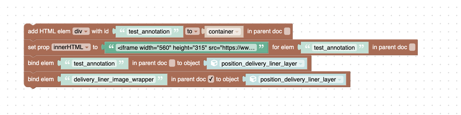

    metabaker
    Enabling the parent doc didn’t work.

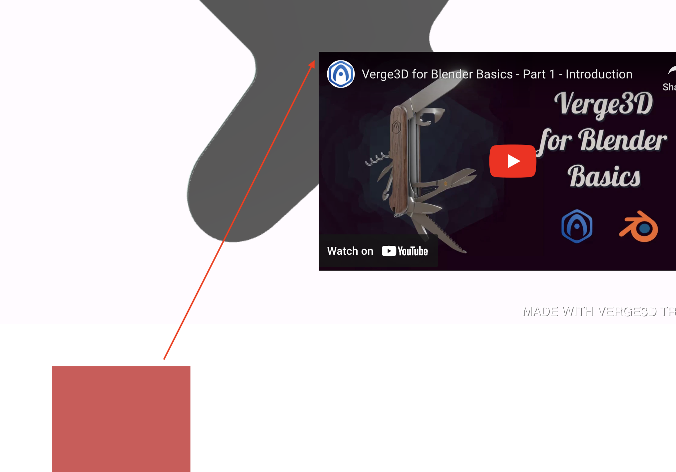

    I am able to bind a youtube video to the object.
    But I’m unable to bind the HTML element (a wrapper div from webflow) to the same object.
    Is there a way to access the element and set it using innerHtml (replace the youtube embed)?

    Missed screenshot
