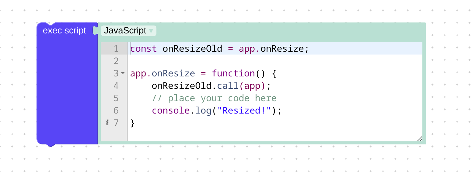

    Hi Ignacio,
    You can use the following code to override the built-in app.onResize() function:
    const onResizeOld = app.onResize;
    app.onResize = function() {
        onResizeOld.call(app);
        // place your code here
        console.log("Resized!");
    Same with Puzzles:

    Thanks a lot for your quick response and for clarifying that I can override the built-in app.onResize() function. This will help me streamline my code!
