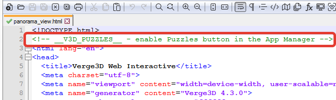

    I’m encountering a problem with the Verge3D application where the puzzle button has become grayed out and unclickable. This issue occurred after I moved a file and then copied it back. I’ve tried restarting the application and reloading the scene, but the problem persists.
    I’m not sure what else to try, so I’m seeking assistance from the community. Can someone please help me restore the puzzle button functionality? Any suggestions or solutions would be greatly appreciated.

    your_app_name.html must contain this text to enable Puzzles’ button

    You’re great, thank you
