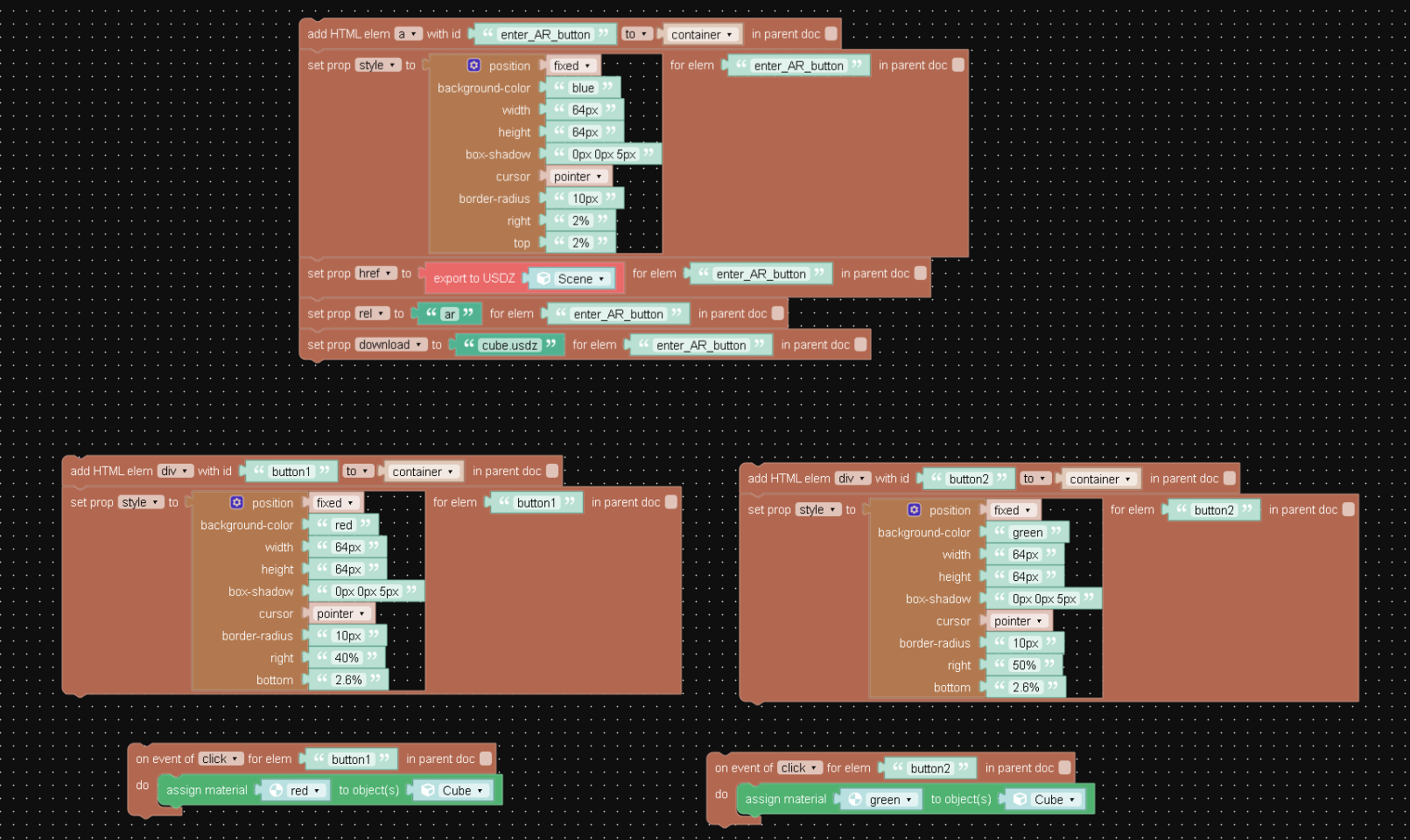

    Hi, this is just a simple case of what I’m trying to achieve with the AR mode :wacko:
    I have a green cube that export perfectly into AR mode :yahoo:
    but if i try to apply a new material to it (like red) and I export it again, it will keep the base material “green” and not export with the new red material.
    try it : https://v3d.net/133h
    if someone has ever faced this issue, i’ll be happy to hear it :good:
    more info :
    it does the same if i set the export usdz to the “cube” model and not to the “scene”.

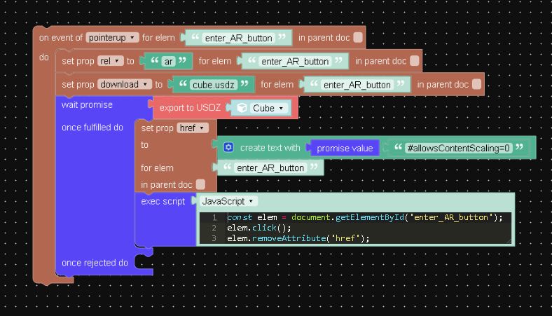

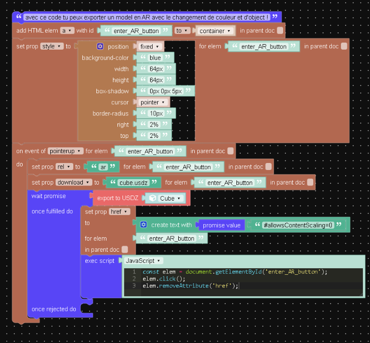

    #78611
    According to the puzzles above your cube is exported to USDZ only once, right after the app has been loaded. To get what you want the cube should be exported on demand, after its material was changed. Puzzles will be a little more complex…

    #78614
    I tried it and nothing happen.
    Did smth wrong. That puzzle set is 100% working.
    #78615
    Nathan Arditti
    My bad, it’s working ! god bless you :yahoo:
    #78798
    Nathan Arditti
    I’m having another issue with the AR mode.
    If I use “puzzle-1” (picture example below). It does export the new material applied to it (which is great).
    But the problem is when I click on the AR button (from my phone) they ask me if I want to download the usdz model, once downloaded, I have to go through the download list and open it from there.
    Compare to “puzzle-2” (picture example below). That if I click on the AR button (from my phone) they ask me if I want to open the 3D file (without having to search it from the download list) which is what I want to achieve. Only problem it doesn’t export the new material applied to it.
    I’m not sure what I can do to fix it.
    The link to the AR 3D scene (using puzzle 1): https://v3d.net/133h
    Thanks for your help!
