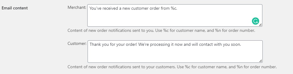

    Hi! I would like to edit the text of an email that is received by the merchant when a new order is placed. I was able to do it with the old Verge3D Plugin, but I don’t know how to do it in the new version released in 2022. :)

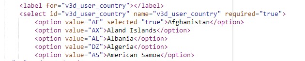

    While placing a new order, the user can select its country from a dropdown menu. I would like to inform the merchant about this choice in the email body, but make it invisible to the user. What kind of command should I use in the Email Content tab in the plugin, to make it work? I know I can add the customer name with %c and the order number with %n. But how to add country information?
    I’m attaching my dropdown code and the plugin screenshot for reference.
    #56283
    Hi Mariusz,
    You can enable billing address in the plugin settings (General tab) and then modify order form (order_form.php) to convert Country input to selector as well as disable all other fields (Address 1,2….).

    #56402
    Mariusz
    Thank you Alexander, it worked! :good:
    I enabled the “Billing address” in the plugin settings, and added this to order_email_body.php:
    <p><?php
                if ($to == $order['user_email']) {
                    echo 'Text for the customer goes here.';
                } else {
                    echo 'Customer name: '.$order['user_name']. "<br>" .
                         'Customer email: '.$order['user_email']. "<br>" .
                         'Customer country: '.$order['user_country']. "<br>" .
                         'Order ID: '.$order_id. "<br>" .
                         'Date: '.date('j M Y');
            ?></p>
