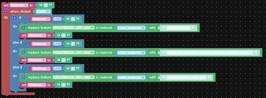

2021-01-27 at 2:49 pm #37756hasanyluthfi
Participantcycling texture between 3 image can be achieved by something like this.
ignore the naming. the explanation is you give current state as variable “material” and mark it as 1.
because there’s logic puzzle that’s detect what mark is assigned to the variable “material”, it will change according to what mark is assigned to that variable “material”.Attachments:

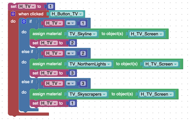

2021-01-27 at 3:07 pm #37759anigizle
Participantcycling texture between 3 image can be achieved by something like this. ignore the naming. the explanation is you give current state as variable “material” and mark it as 1. because there’s logic puzzle that’s detect what mark is assigned to the variable “material”, it will change according to what mark is assigned to that variable “material”.
Thanks hasanyluthfi. The problem that I have during this puzzle is when “TV_NorthernLights” is shown you must click the button twice and then it skips the “TV_skyscrapers”.. So the cycle isn’t completely working…
2021-01-28 at 3:09 am #37768hasanyluthfi
Participantmaybe check your material?, just in case your TV_NorthernLights have same texture as TV_skyscrapers.
and why not use change texture puzzle instead?2021-01-28 at 1:12 pm #37791anigizle
Participantmaybe check your material?, just in case your TV_NorthernLights have same texture as TV_skyscrapers. and why not use change texture puzzle instead?
Thanks hasanyluthfi the method of replacing textures fixed it!
