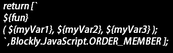

GLiFTeKCustomerSOLUTION:
if you’re having this problem with the setOutput option for the BlockConnection and get the ‘expecting tuple’ console error…
if using the ‘Mitigating Code Bloat‘ method,
you have to use square brackets and a blockly.javascript tag as well.ie: (at the end of your function code(block), after your “FUNCTION_NAME_PLACEHOLDER_” JS code ) use:
impotant that in your myFunction (var fun) JS you have a ‘return myVar1’ for the var you want returned through the plug output!

plz share Discord link & on your signature!2020-12-31 at 12:28 am #36982jem
Customer@GlifTek, thank you for figuring out the square bracket issue. I just ran into this error. Your solution worked for me!
