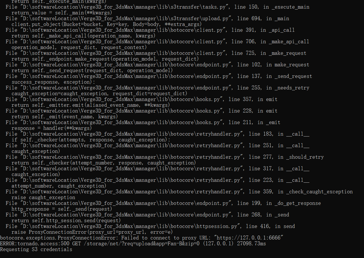

    Clash is used as a proxy in my computer, But still can’t access verge3d network, exception occurred as the screenshot below.

    Proxy servers are not supported by Verge3D at the time. Please try VPN instead if you have troubles accessing our server.
    Anyway, I’m going to add this task to our TODO list. :mail:

    thank u for your answer,I switched the system proxy mode into TUN mode in clash and stoped firewall in my computer,it worked!
