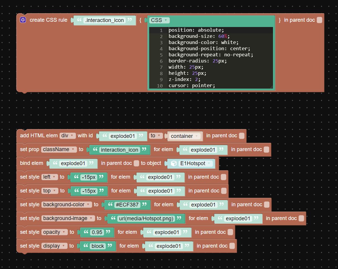

    I am using Verge3D 4.4. I tried to bind an HTML element (as simple image) to a 3D object in AR experience on an Android device. While the HTML element is correctly bound to the object and displays an image, it moves inconsistently with the camera, not staying fixed to the object as expected.
    Please check the attached puzzle code. Thanks.

    Hi ps,
    Such the feature is not supported at the moment :unsure: We’ll try to find out if we can implement it :good:

    Hi Yuri,
    Thanks for your reply. But I can see that annotations are working properly in AR. Is there any way that I can bring such functionality into binding HTML element.
    If possible could you provide some reference code from annotations, with respect to anchoring it on a object. Thank you.

    It appears this is an easy fix. Going to ship it with the first preview of v.4.8 which we are releasing likely on the next week. Stay tuned!
