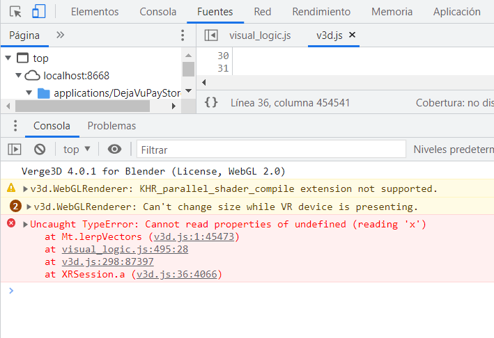

    Alberto Leuro
    I’m not a developer, but I hope this helps to find the solution.
    I am using the version Version: 4.1.1 in the app manager

    #57448
    You have an error in your logic. Line 495 in visual_logic.js. Your script tries to read properties of an undefined object.
