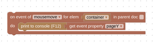

Great progress indeed. So you need to determine the sign of the dragging delta along vertical screen axis, right? Then can you possibly create a variable and remember the coordinate of the mouse cursor at the moment the user starts dragging. Then you could compare it with that at the moment the dragging is finished.
You can retrieve the mouse coordinates using these puzzles:
https://www.soft8soft.com/docs/manual/en/puzzles/HTML.html#event (select ‘mousemove’)
and
https://www.soft8soft.com/docs/manual/en/puzzles/HTML.html#get_event_property
(select ‘pageY’)

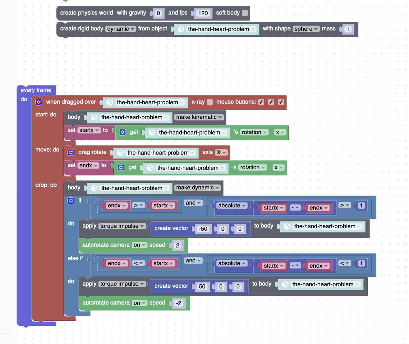

2020-08-28 at 9:36 am #32119cfxs
CustomerFinnaly got it working! For everyone who runs in to the same questions. Here is my setup.

GLiFTeKCustomerFinnaly got it working! For everyone who runs in to the same questions. Here is my setup.
Nice job!
plz share Discord link & on your signature!2022-10-23 at 2:13 am #56753auriea
CustomerI have found thd threads in this forum so helpful I feel I should give back. So, here is how I solved this problem.
