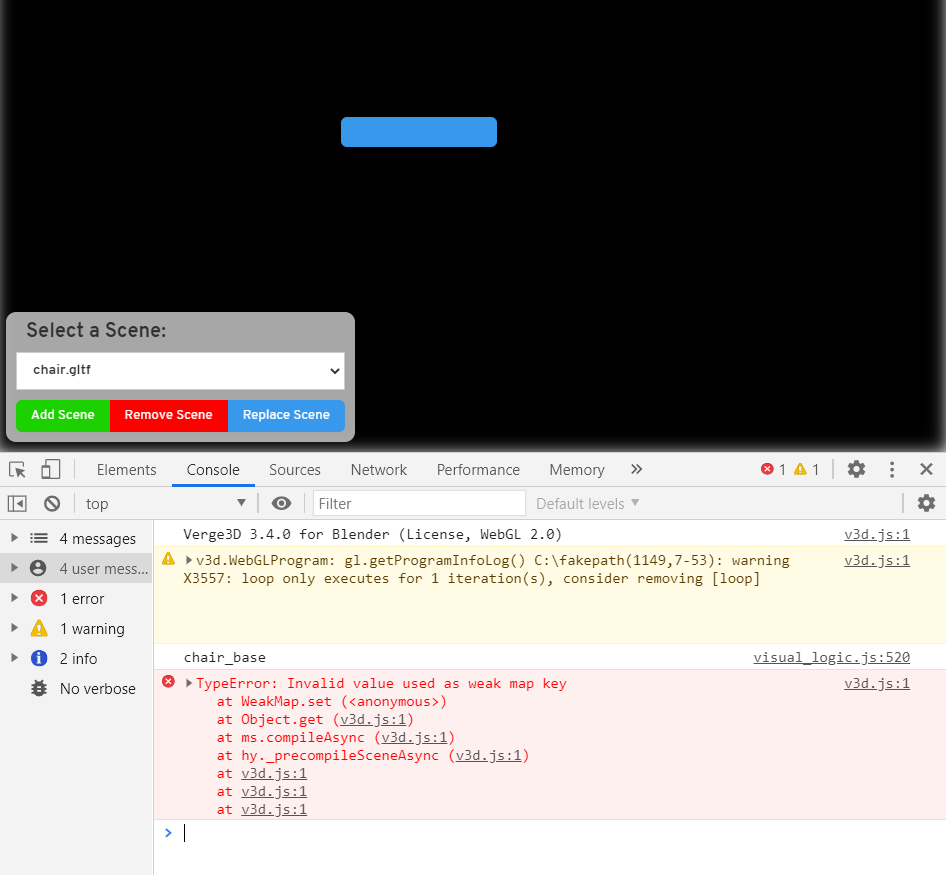

CustomerI have a number of appended scenes which were working perfectly well prior to the update. The scenes no longer append. I see this error in console but have no idea to what it refers..?
Uncaught TypeError: Failed to execute ‘getProgramParameter’ on ‘WebGL2RenderingContext’: parameter 1 is not of type ‘WebGLProgram’.
at v3d.js:1The errors accumulate as I watch in console, which only adds to my confusion.
I’ve tried both suggested methods to update my app but the problem persists.
Any ideas as to where I might be going wrong?

CustomerHi Alexander,
I’ve played with the Load Unload demo, it appears to work ok except for when I unload everything and attempt to ‘add scene’ it locks up as per attached screenshot.

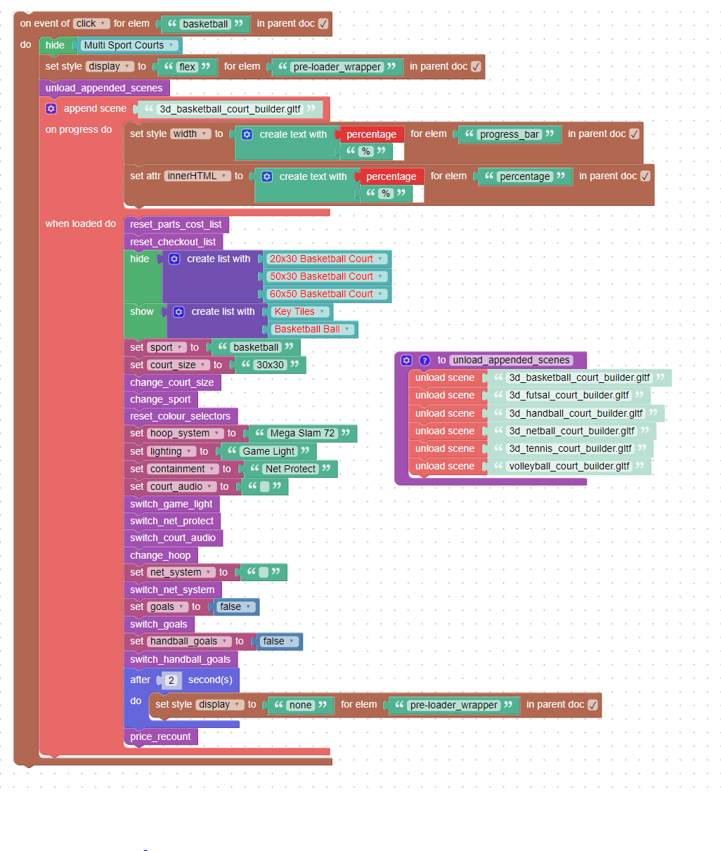

I’ve included my rather convoluted method of appending files, which may assist any diagnosis. I shall in the meanwhile, attempt to reproduce the error in a basic project..2020-09-25 at 8:23 am #33330

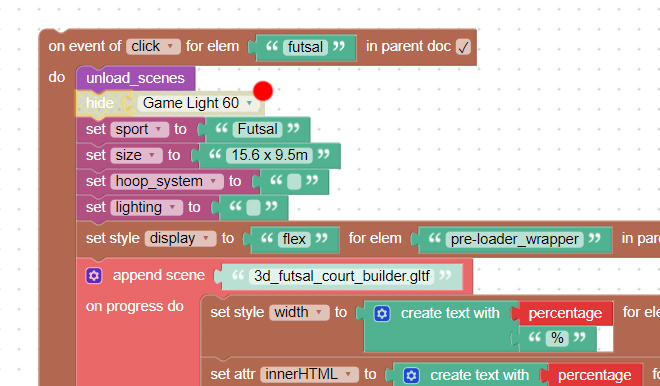

Yuri KovelenovStaff2020-09-30 at 1:02 pm #33630scott.vincent
CustomerHere’s a simplified working version of my sport court app where the issue persists. The full and live version works fine here.
In the attached screenshot, you can see a disabled ‘hide – Game Light 60’. If this is enabled the appending of the scenes (Futsal and Tennis) ceases to work. Non lighting related objects can be switched with impunity.
