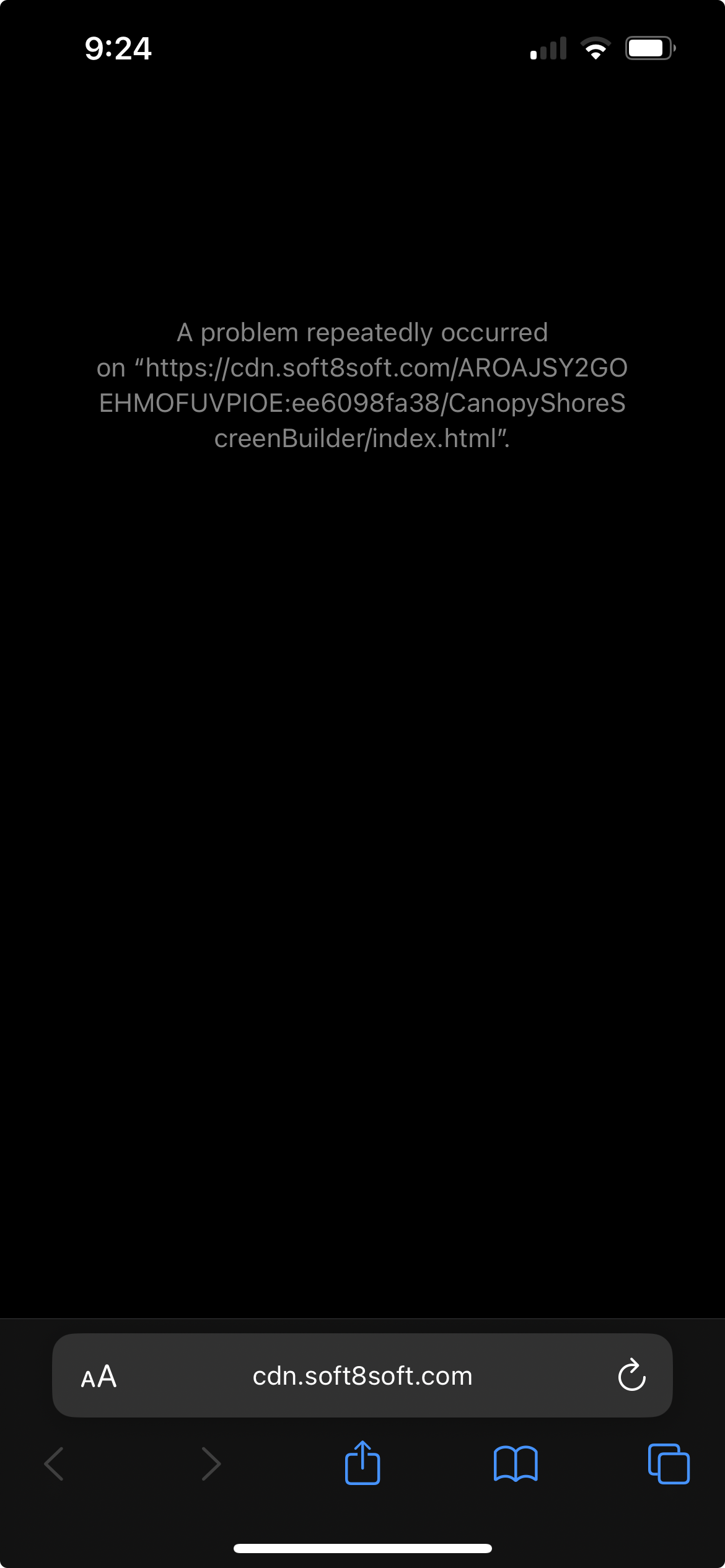

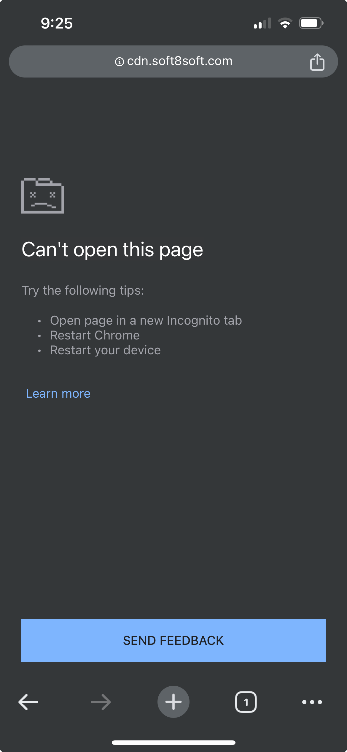

CustomerMy app is all of a sudden crashing during the loading process on ios browsers. Tries to load a couple times, and then the browser gives up and shows an error message (see attached).
Running Verge 4.7. App is updated. Working fine on desktop.

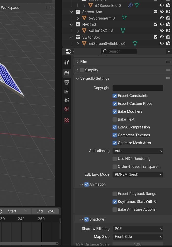

I have disabled almost all of my “print to console” prompts. I have deleted all Camera and Light objects out of all of my Blender models. I have the “Compress Textures” box checked in the Verge3D Settings on Blender for all my Blender models.
I have cleared my iPhone’s entire browser history on both Safari and Chrome, still getting this error message (“A problem repeatedly occurred…”).

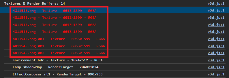

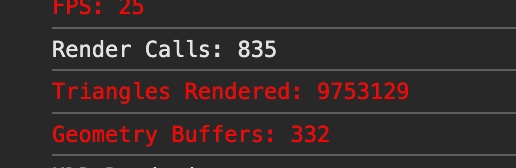

Tutorials - https://www.xeons3dlab.com2024-08-02 at 6:34 pm #76364eabrosius
CustomerSorry guys I’m not sure how to interpret this feedback exactly. Are those red-text Texture-related messages indicate that those particular png files are too large, not the ideal dimensions, or something else?
And then as far as the triangles rendered message… do I need to look into how to use Blender to reduce the complexity of my blender models so that there are less triangles rendered?
2024-08-02 at 8:53 pm #76366kdv
Participantthose particular png files are too large, not the ideal dimensions
both. get rid of them. use only power-of-two dimensions and keep in mind that even 4k textures can crach your app in iOS.
The funniest thing is that I don’t even see this picture in your configurator )))
