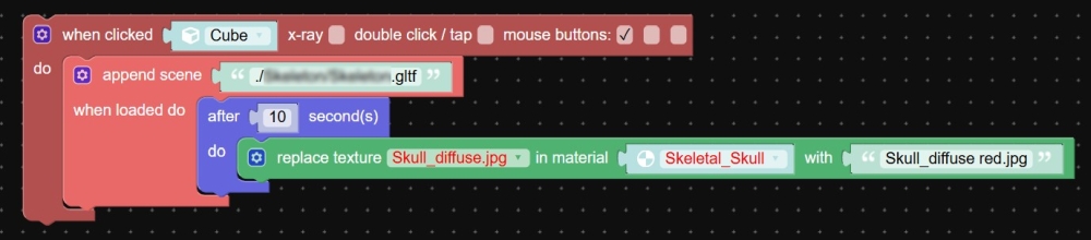

    I have come across a situation where there is a scene which loads initially and based on object click the scene appends with a skull.
    now here is a problem I am facing….
    Ias shown in puzzle screenshot I want to change the texture in skull for some reason after the scene is appended. But initially I cant set it up since there is no choice to select the skull as it is not loaded. See the red marked names in puzzle list.
    How do I manage this?
    Any clue / solution?

    I know after clicking cube in my case in puzzle editor the choice becomes valid but how it will function ultimately after file is published ? it doesn’t.
    for am moment I click on cube and things get cleared but the further action required after 10 seconds doesn’t take place as per the puzzle sequence. thats the issue.

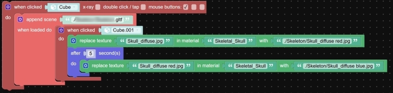

    Yes this one worked. But I found one issue in this.
    check screenshot the first attempt texture change happens but the second attempt doesn’t happen. I tried checking it with when clicked, time delay both ways. It doesn’t change further.
    Technically if one attempt happens then there shouldn’t be any limit but it is seen so.

    “replace texture” puzzle doesn’t rename textures in materials. in your case the name will always remain “Skull_diffise.jpg”.
    Why not? It’s working as expected…

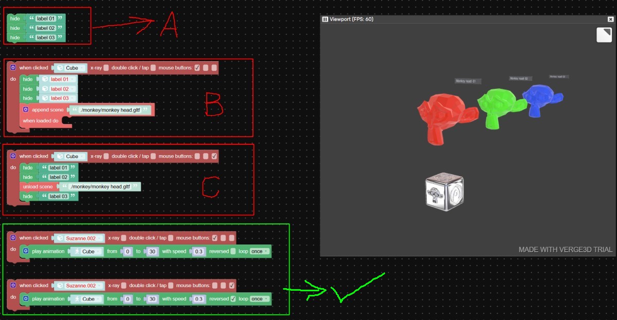

    `Yes you rare correct. I should have given clearer view here.
    Here I am attaching the reference setup scene.
    the screenshot is also attached.
    as you see the animation of cube happens when gltf is loaded but hiding of the labels is not working as expected when external scene is loaded.
    I tried it three ways as marked with A, B & C
    I just wonder… Is there any chance that someday you will start using logic in your puzzles? :wacko:

    visualizer
    Yes I used this rearrangement already by putting the things after appending scene. That was a missed arrangement I agree. :good:
