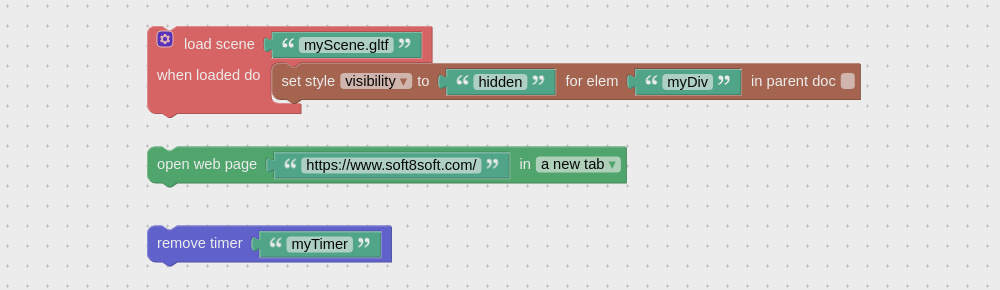

The text puzzle is often used with puzzles from different categories. Particularly, you can specify URL inputs to scene loader puzzles, HTML element ids, CSS rules and colors to HTML puzzles, and ids and URLs to some other puzzles.
![Text block example](files/puzzles/puzzles-text-text-example2.jpg)

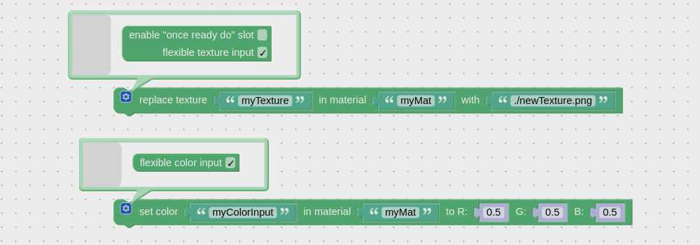

Finally, some puzzles are configurable to provide textual input instead of the default dropdown menu which is also useful in the case of dynamically loaded scenes.
![Using text blocks instead for dropdowns](files/puzzles/puzzles-text-text-example3.jpg)

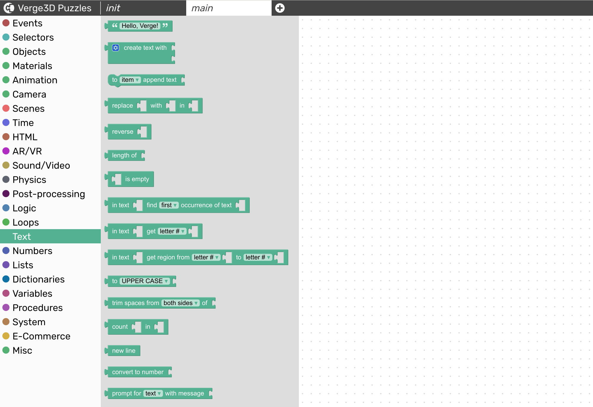

text multi-line
This puzzle provides the means to supply some text to your Puzzles scenario. The puzzle uses Ace Editor for displaying and editing the content. See the relevant keyboard shortcuts here: Default Keyboard Shortcuts.
The puzzle supports CSS, HTML, Javascript and plain text highlighting modes, which can be switched on the fly. The puzzle can be resized to change the editor's width and height.
![Visual programming block to create multiline text](files/puzzles/puzzles-text-text-multiline.png)

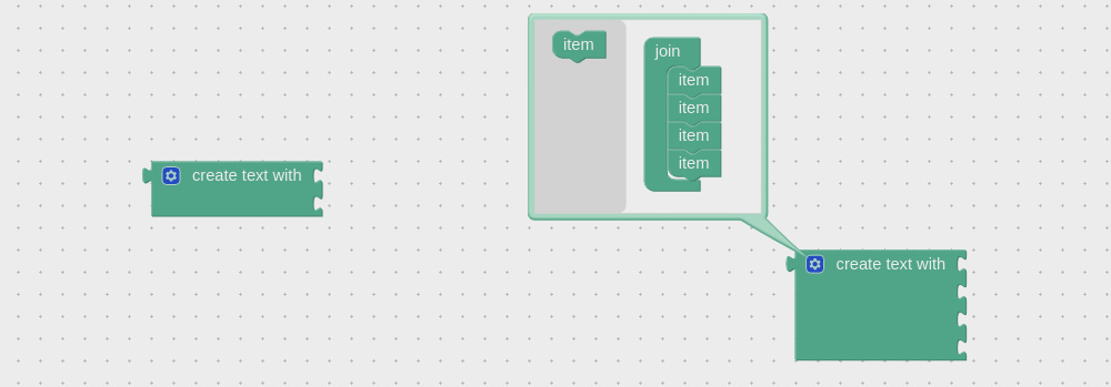

create text
This puzzle allows you to combine (concatenate) 2 or more pieces of text into a single line. If you provide non-textual values such as numbers, they will be automatically converted to text. Additional inputs are added by dragging an item block from the gray toolbox on the left into the join block.
![Visual logic block to concatenate text scrings](files/puzzles/puzzles-text-create-text.jpg)
Example: create an annotation composed of some text and the object name.
![Concatenate example](files/puzzles/puzzles-text-create-text-example.jpg)

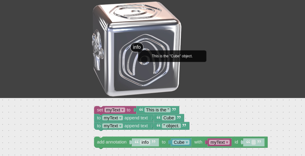

append text
This puzzle adds the given text to the specified variable.
![Block to append text value to a variable](files/puzzles/puzzles-text-append-text.jpg)
![Append text block example](files/puzzles/puzzles-text-append-text-example.jpg)

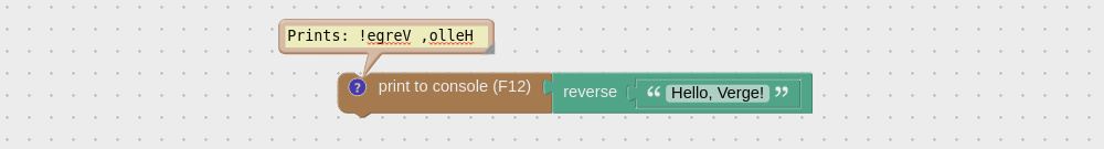

reverse
This puzzle reverses the given piece of text.
![Visual logic block to reverse text](files/puzzles/puzzles-text-reverse.jpg)
Example:
![Reversing text example](files/puzzles/puzzles-text-reverse-example.jpg)

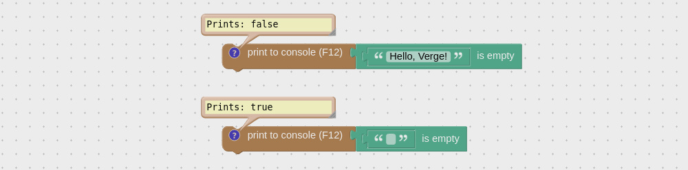

is empty
This puzzle checks whether the given text is empty (has length 0). The result is true if this is the case and false if not. For using with Logic puzzles.
![Visual coding block to check if string is empty](files/puzzles/puzzles-text-is-empty.jpg)
Examples:
![Checking if string is empty](files/puzzles/puzzles-text-is-empty-example.jpg)

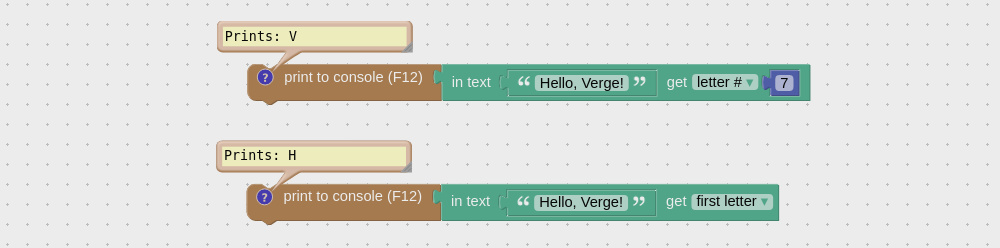

get letter
This puzzle extracts the character from the specified position (characters in text are indexed starting from 0).
![Get letter visual programming block](files/puzzles/puzzles-text-get-letter.jpg)
Examples:
![Getting string letter](files/puzzles/puzzles-text-get-letter-example.jpg)

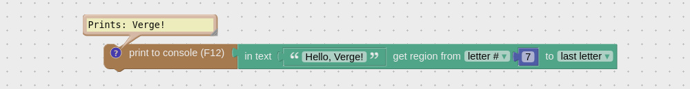

get region
This puzzle allows a region of text between two specified positions to be extracted (characters in text are indexed starting from 0).
![Get region visual programming block](files/puzzles/puzzles-text-get-region.jpg)
Example:
![Getting text region example](files/puzzles/puzzles-text-get-region-example.jpg)

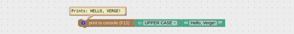

adjust case
This puzzle creates a version of the input text that is either UPPER CASE (all letters upper-case), lower case or Title Case (first letters upper-case, other letters lower-case). Non-alphabetic characters, and text in languages without case, such as Chinese, are not affected.
![Visual logic block to adjust text case](files/puzzles/puzzles-text-adjust-case.jpg)
Example:
![Using adjust case block](files/puzzles/puzzles-text-adjust-case-example.jpg)

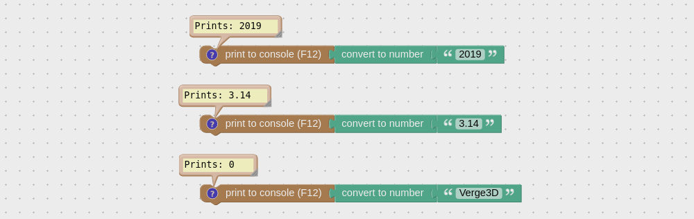

convert to number
This puzzle tries to convert the specified text to number, so that the obtained value can be used as input for numeric operations. If conversion fails, returns 0.
![Convert text to number with visual programming](files/puzzles/puzzles-text-convert-to-number.jpg)
Examples:
![Text to number example script](files/puzzles/puzzles-text-convert-to-number-example.jpg)

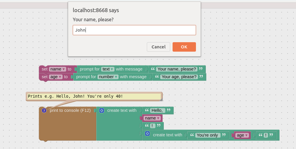

prompt
This puzzle creates a pop-up window with an input field. The execution chain pauses until the user clicks OK or Cancel buttons, after which the puzzle returns the input value.
![Prompt user for text visual logic block](files/puzzles/puzzles-text-prompt.jpg)
Example:
![Prompt example script](files/puzzles/puzzles-text-prompt-example.jpg)
