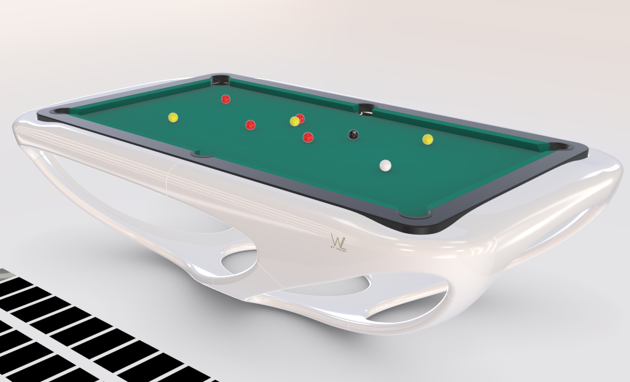

NaxosCGCustomerHello there,
Here is my very first real project using Verge3D.The final web page will give the possibility to change several colors / shaders.
It is meant to replace, time after time, the existing web site using PNG layers in DIVs, you can see it here : https://configurateur.billard-toulet.com/
The 3D in the existing website was also made by me
I’ll probably ask some help in the future to get things right, nice and cleverly done.
First of all, i wish i could use nVidia’s raytracing to get rid of the white contour around the balls…
Or a progressive rendering like in 3dsmax in high quality viewport.PS : i’m not responsible for the table design, it is (c) Toulet and may not be used elsewhere.

Yuri KovelenovStaffexcellent work! keep it up and keep us posted about your progress!
