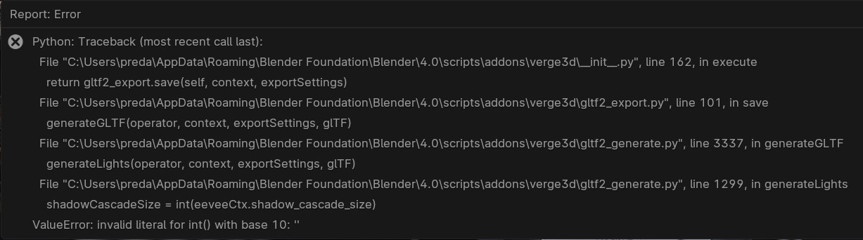

    If you are upgrading publishing of verge scenes from Blender 4..0 to 4.3 then you will have shader errors mostly and scene will not be as expected.
    Here is a main glitch… if you jump back from Blender 4.3 & open the same scene with 4.0 & publish then verge will flash this error when you export verge gltf from Blender.

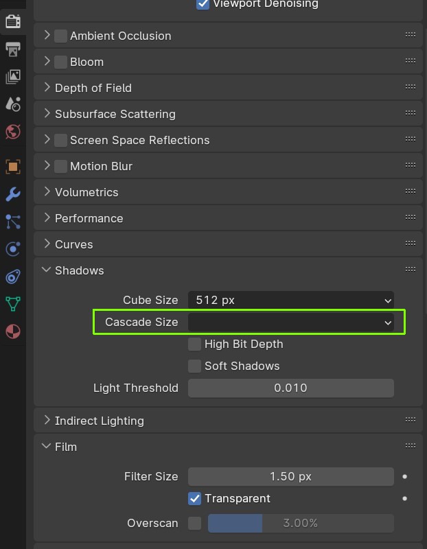

    This has s simple fix ( clipboard 002.jpg)
    Evee shader cascade size. Dont know why & how but it appears blank. You just have to fix by selecting suitable value. Thats it.
