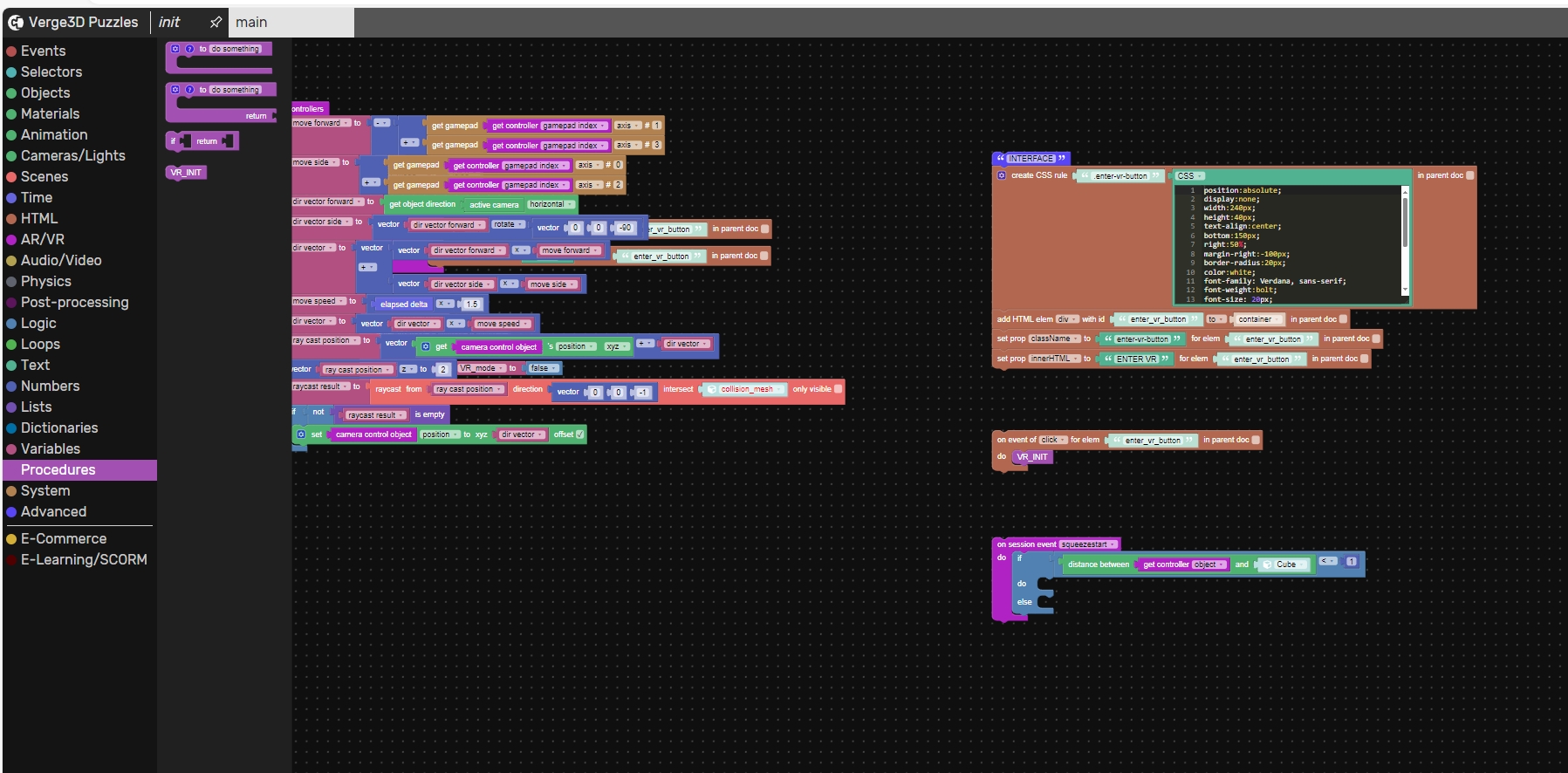

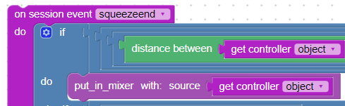

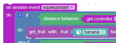

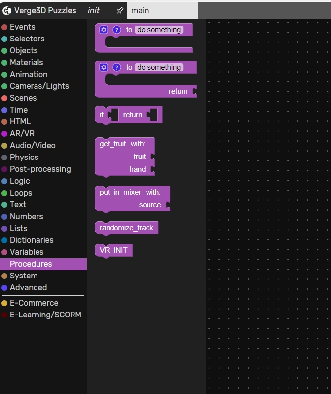

I made 2 Screenshots. 01 is from the VR-Reality Sample and there are some more
puzzles to drag in, i.e. the puzzle get_fruit_with….
This puzzle isn’t existent in my own project. Where is this generated ?edit: aah I see where
