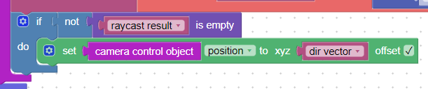

    Next up would be following slopes/climbing stairs. The raycast stuff in the “VR Controls” looks like it might be trying to do that, but it doesn’t work like it seems it should. It will follow a floor, but ignore slopes/stairs.
    #68329
    Create the collision mesh properly (see the Firstperson Camera demo as anexample) and it will work.
    #68333
    bigcatrik
    In this example playing first-person on flatscreen (wasd plus mouse) allows one to climb the stairs and go up the ramp, but playing the same file in VR (Quest 2) will go right through them. Both flatscreen and VR use the same collision shape. First-person mode uses Verge3D’s collision shape/texture option and the VR version uses the Verge3D “VR Controls” setup from the library with the collision shape entered in the proper puzzle.
    https://v3d.net/pp3
    #68334
    The proplem is here:
    This whole puzzles set is a very simplified analogue of the First Person controls and initially provides only horizontal moving. The intersection point’s Z coordinate is not taken into account. That’s why you move horizontally through the sloped parts of the collision mesh.
