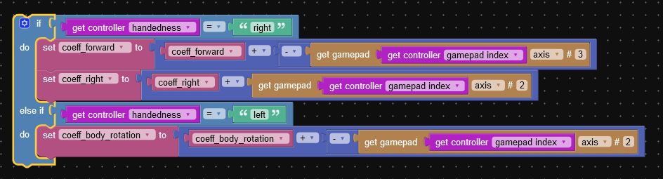

you should be able to address the thumb sticks’ axes separately by checking the controllers handedness (left, right) first. Numbers for the axes seem to be the same, while the handedness is not. I’ve attached an example from my project (right stick is used for walking and moving sideways while the left stick rotates the view).
2023-11-09 at 10:49 pm #68328
bigcatrikParticipantyou should be able to address the thumb sticks’ axes separately by checking the controllers handedness (left, right) first.
Thanks! That put me on the right track.
