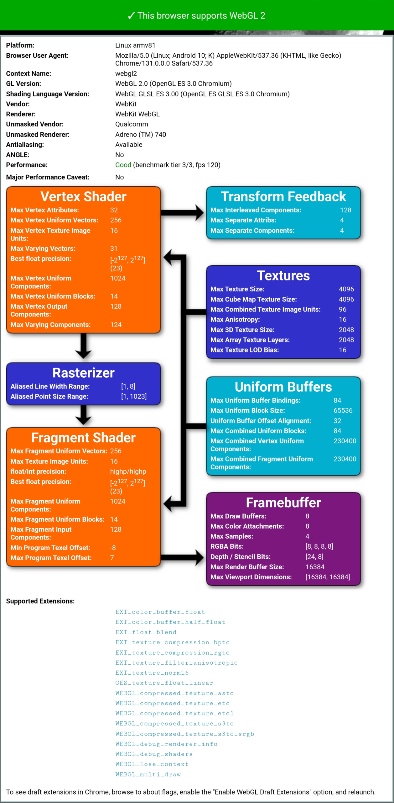

    #79724
    If you visit WebGL System Report using your tablet, what does it show?
    #79767
    tomtm
    Hi Yuri
    Here are the infos of my Galaxy Tab S9
