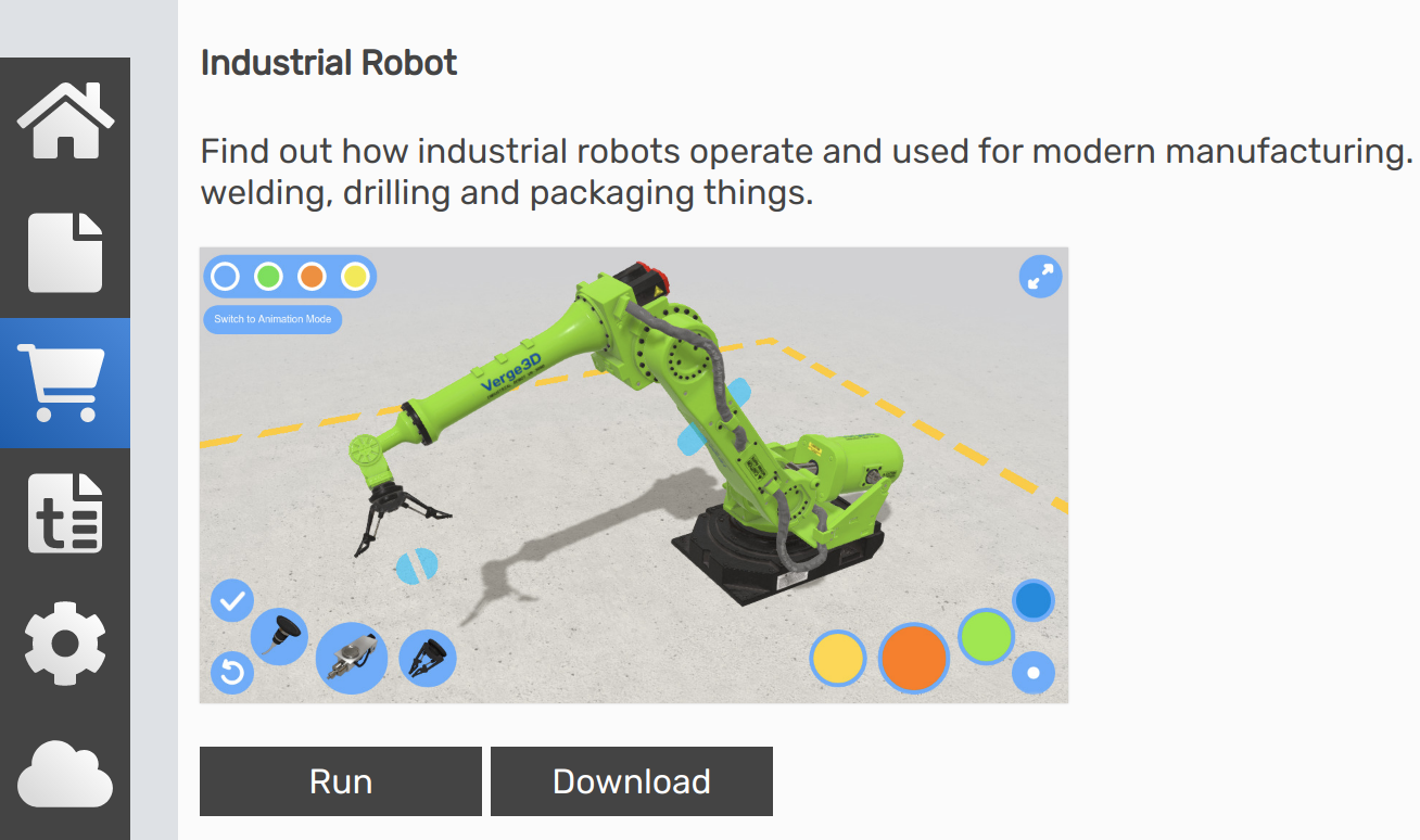

After installing Verge3D 4.0, you won’t see any stock demos listed in the App Manager (thus the distributions file size is only about 100 Mb now). The demos can now be freely downloaded upon request from the store section of the App Manager. We plan to add to this store various simple examples for more convenient learning how this or that feature works.

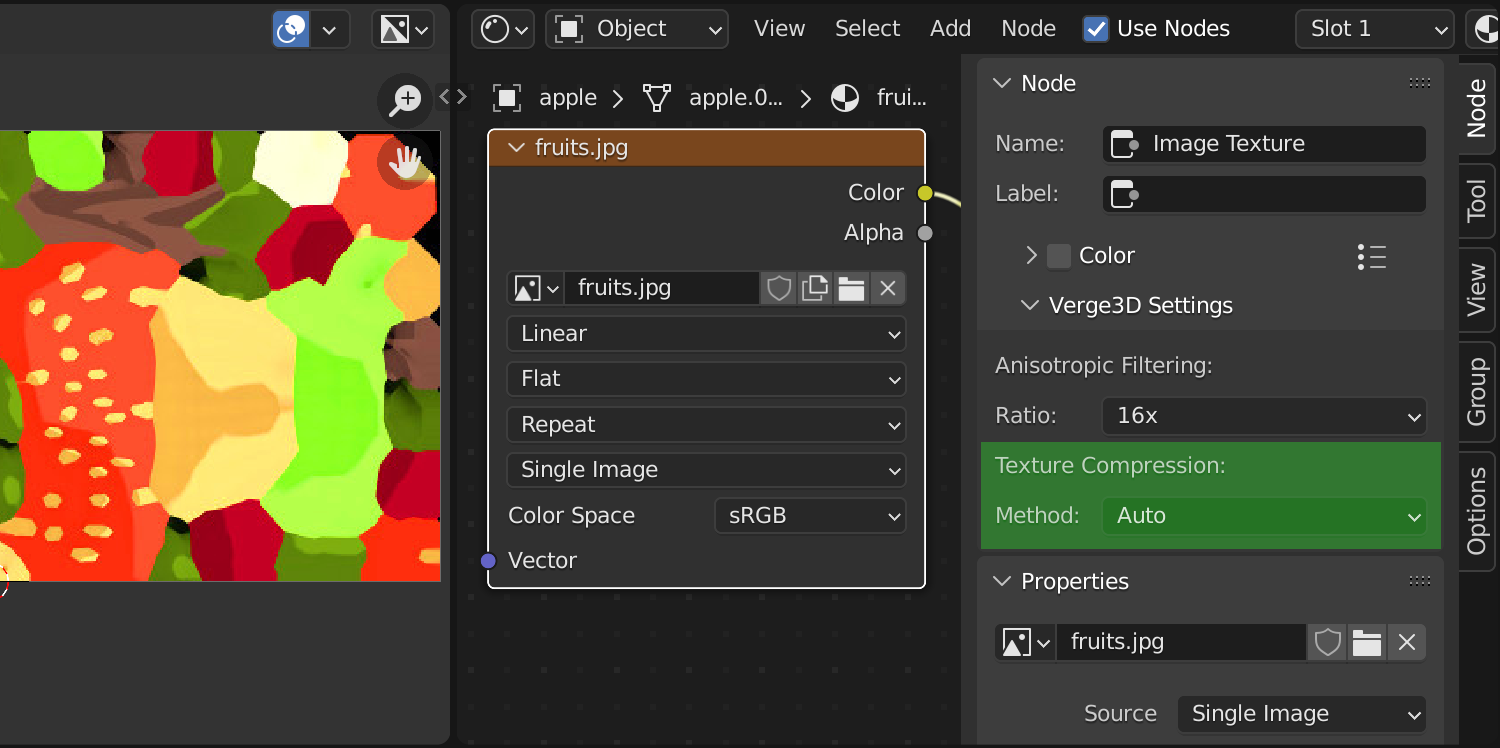

Here goes one of the most important features of this release. Texture compression enables images to use 4x-6x less video memory, decreases the overall size of files a Verge3D app needs to load, and speeds up rendering thanks to more efficient memory access. This feature is especially crucial to hardware-restricted Apple devices, since insufficient memory is the main reason for big scenes crushing on iOS.
Texture compression is performed when you export a scene, if you enable the corresponding option.

Verge3D employs two compression algorithms which you can switch between:
- UASTC is a modern method which offers best quality. It is good for everything including normal maps, ORM textures, etc.
- ETC1S offers best compression and generates smallest files. However, it may cripple textures so you might use it only for non-contrast images (such as grass, wood, bricks, etc).
You can tweak efficiency-vs-quality by choosing the compression algorithm for each individual texture.
Blender:
3ds Max:
Maya:
However, you don’t really need to choose between them and can safely leave the default Auto option, that corresponds to simply using UASTC in the current implementation (this behavior may change in the future).

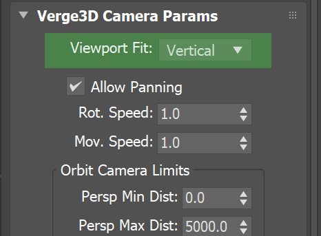

The Viewport Fit option (Vertical or Horizontal) is now available for cameras. You can use it to properly adjust your 3D UI elements to the user’s screen resolution. Thanks for suggesting this feature.

All so called “player-based” demos that were causing much confusion among users were converted to “normal” apps, that is, are supplied with a mandatory .html file to run them.

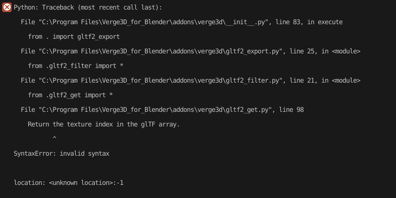

I’m trying to export scene now, but an issue is happening :
Python: Traceback (most recent call last):
File “C:\Program Files\Verge3D_for_Blender\addons\verge3d\__init__.py”, line 83, in execute
from . import gltf2_export
File “C:\Program Files\Verge3D_for_Blender\addons\verge3d\gltf2_export.py”, line 25, in <module>
from .gltf2_filter import *
File “C:\Program Files\Verge3D_for_Blender\addons\verge3d\gltf2_filter.py”, line 21, in <module>
from .gltf2_get import *
File “C:\Program Files\Verge3D_for_Blender\addons\verge3d\gltf2_get.py”, line 98
Return the texture index in the glTF array.
SyntaxError: invalid syntaxlocation: <unknown location>:-1

Yuri KovelenovStaffhi,
can you share this .blend file?
