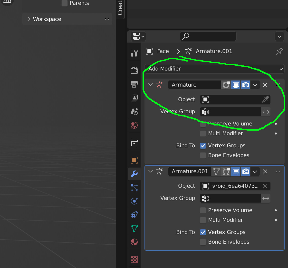

    #47468
    dyn-do

    There are 2 armature modifiers on your “Face” mesh which is not supported by Verge3D. The first one has no Armature object attached which causes crash in runtime. Please remove it to make it work.
    #47834
    dyn-do
    It worked! Thank you very much.!:yahoo:
