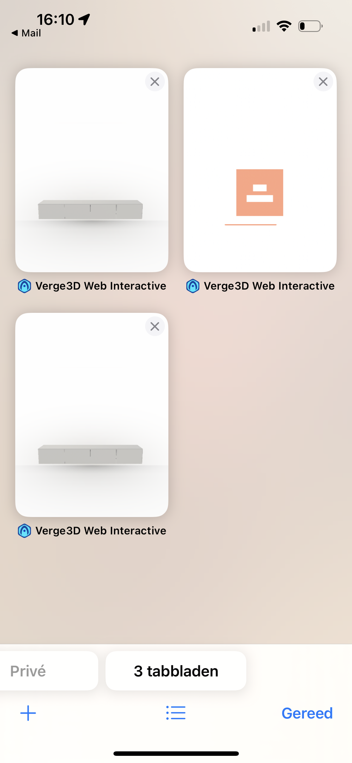

studiogijsCustomerIn the meantime I did make a few changes based on suggestions by @xeon, turning off the lights in the scene and turning off HDR rendering. Try opening the app in several tabs, and you will see it starts behaving badly. Or open the app in both safari and chrome at the same time.
I think it is likely to happen if a customer is going to open the app multiple times to compare several options, or maybe even inadvertantly because they leave the app open on one page and open the app again at some other point on a new page, but this is not sure of course. I’m happy to hear though that the app runs on phones you tried. Are these phones all on 17.4.1?
When the app is open on multiple pages/ browsers something is going wrong, and I don’t know what it is, which makes it hard to debug. Is it memory? What causes the model to turn black or loose context?

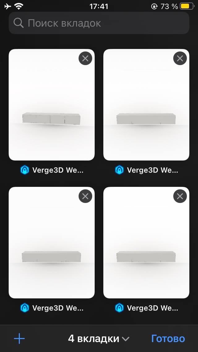

2024-04-24 at 1:45 pm #72492kdv
ParticipantMy old iPhone SE (with just 2 GB of RAM) is able to run your app in three tabs at the same time without reloading the page. if using four tabs one of them is being reloaded when opened again (out of memory).
2024-04-24 at 2:11 pm #72494
studiogijsCustomerInteresting
I get a hang already on the third tab on iPhone 14 Pro with iOS 17.4.1What iOS are you running on that SE?
