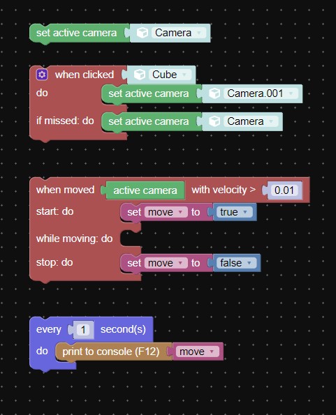

    to reproduce this issue:
    Verge 4.6.0 create new app, Blender 4.1.1 create scene with two cameras, one orbital, and one first-person, and a cube, export gltf to app folder.
    in puzzles, create a puzzle setup that allows for switching between those two cameras, and then use a “when moved” puzzle to switch a variable from false to true, based on active camera motion, have a print to console puzzle every 1 second to record this variable to verify that “when moved” = “active camera” only works for the initial active camera.

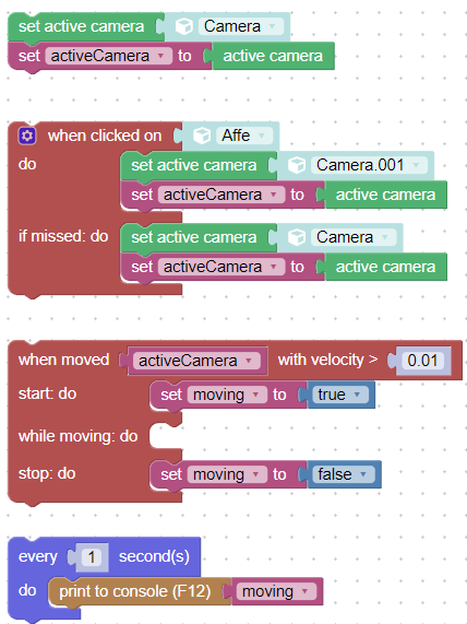

    #72512
    It won’t work as expected the way you did (target camera can’t be changed in your case) and it’s not an issue. It will work this way:
