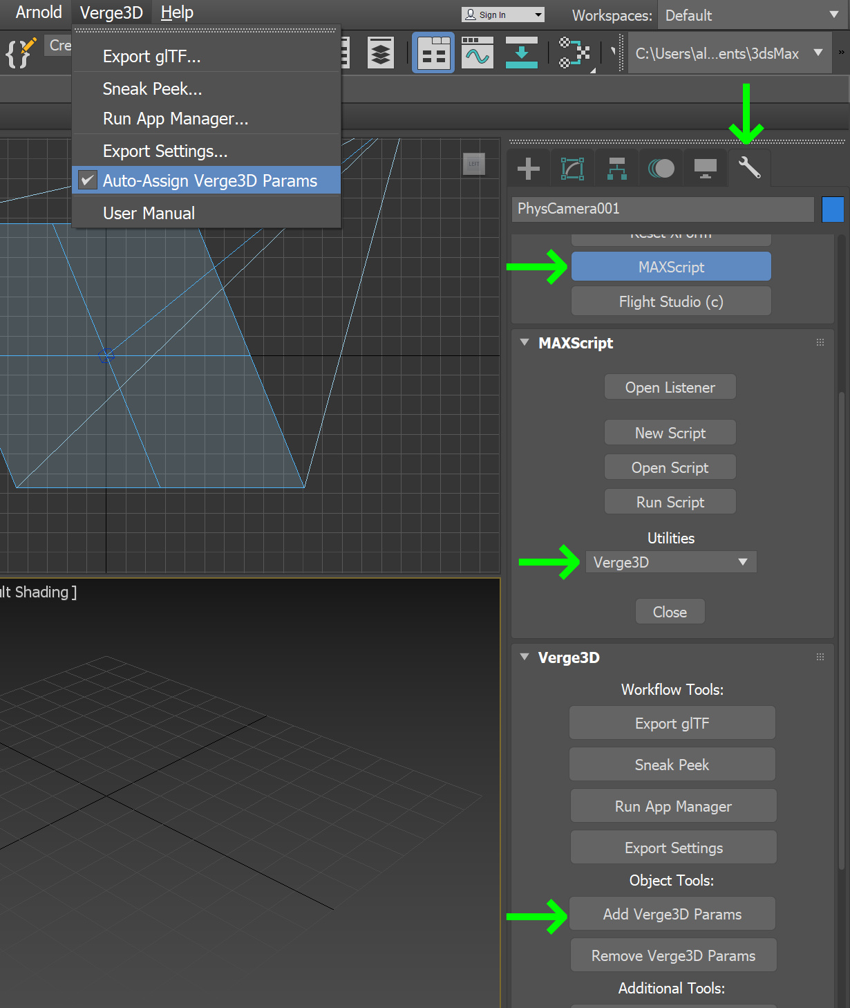

    Did these settings get moved somewhere? I updated Verge and I can no longer find these settings in physical camera.
    VergeCamParams
    #18750
    These settings should be there by default. They are added automatically upon object creation if
    Verge3D > Auto-Assign Verge3D Params is enabled.
    Verge3D params are not created though in the cases when you import a scene, open a file which was created before Verge3D was installed, or if the above-mentioned option is switched off.
    Anyway, you can add Verge3D settings to an existing camera manually, by going to the Utilities tab, selecting Verge3D under MAXScript and clicking Add Verge3D Params for a selected camera.
