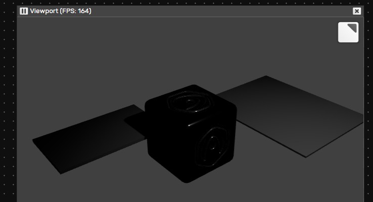

    Verge 4.9.2 is not compatible with Blender 4.5?
    because when I publish scene from Blender 4.5 it appears black as if no hdri is assigned.
    While in 4.2 it is working normal

    Indeed, Verge3D 4.9.2 does not work with Blender 4.5. See this table for additional info.
    Also you might look into Verge3D Life Cycle guide for the rationale behind our decision to support limited versions with each release (basically it’s not our idea, but the maintenance policy for Blender/Max/Maya updates).
