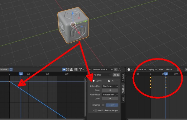

    A simple cube rotation is jumping abnormally and not running smooth . I noticed this after upgrading to 4.3.1.
    this never happened in 4.1.1 ..what is the reason? & whats the fix?

    You may want to see more detail in this thread:
    Linear Animation
    Soft8Soft response:
    ““Unfortunately this is not a bug, but a limitation of glTF format which can’t store Euler angles (only quaternions). Basically, the 0 and 360 rotation is the same, so the cube is motionless. To make it work you need to supply a couple of intermediate keyframes in-between.
    If you don’t use “linear” and just use your bezier handles and shrink them to 0 lengths… it will work…but linear rotation is just a mess.

    Hi
    Agreed !
    As you said having some keyframes in between will keep the motion going ahead. instead of just key at start & end.
    I check by baking the animation sequence. It is working perfectly alright.
    I was wondering why I noticed it in 4.3.1 & not before?
