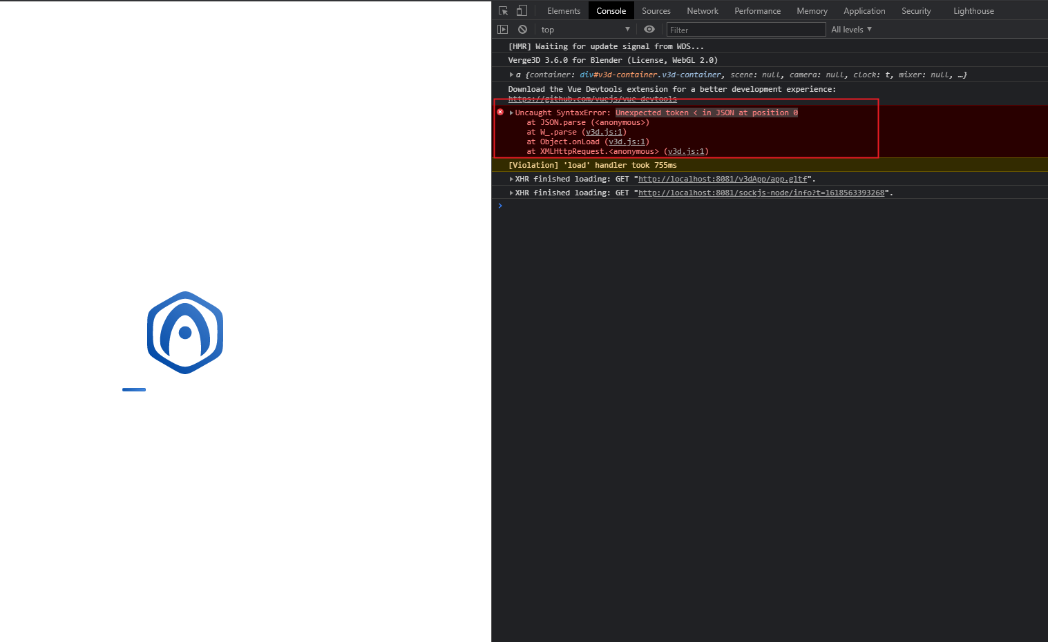

    I created a new vue using webpack
    vue init webpack
    Introduce v3d error report。
    The error is reported in the attachment below。
    #40242
    Are you sure you’re trying to load a valid glTF file? Check it in the App Manager or make a reexport.
    #40383
    feiyanlei
    It is indeed my problem, the REL_URL_PREFIX in app.js has not been modified, thank you very much :good: :good: :good:
