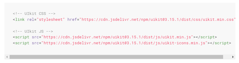

is this script embedded into .html like this?
<script src=”path/UIkit.js”></script>Try
offcanvas(textArg).toggle();instead ofUIkit.offcanvas(textArg).toggle();Puzzles and JS coding. Fast and expensive.
2022-08-05 at 11:48 pm #54657
AubreyCustomerunfortunately no, I get
Uncaught ReferenceError: offcanvas is not definedTo call the component you need UIkit as seen in their docs here.
I’m not familiar enough with javascript but how would you import or include the library in the V3d projects js file?2022-08-06 at 12:27 am #54658kdv
Participantjust copy and paste this into your_app.html
from here https://getuikit.com/docs/installationPuzzles and JS coding. Fast and expensive.

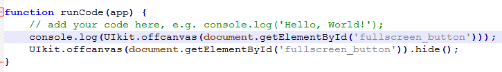

2022-08-06 at 1:25 am #54664
AubreyCustomerAh, think that is what I was looking for, I have put the
document.getElementById in there and now not getting error but still not pulling up the window its supposed to.One step closer, thanks!
