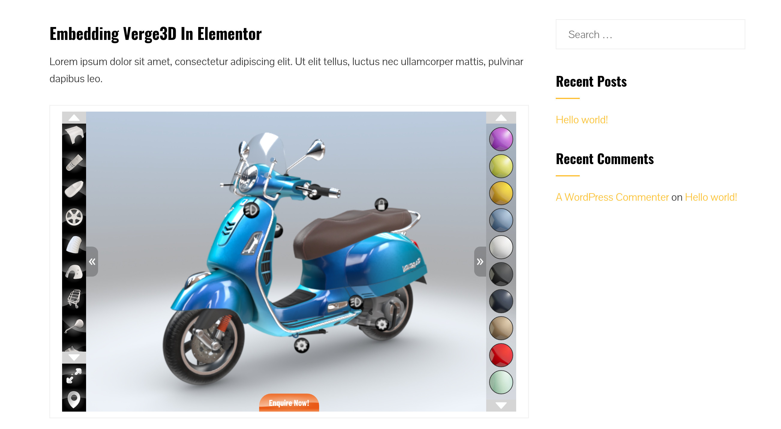

ParticipantI’ve been looking to see if there was a way for me to use Elementor, which is a WP designing tool that I am trying to use with Verge 3D. I’ve built a template with Elementor, but it does not show the Verge 3D model. Any suggestions?
2021-04-03 at 7:29 pm #39893
Alexander KovelenovStaffHi,
It should be quite an easy task to embed Verge3D-based application to a WordPress page made with Elementor. One of the possible ways to do so would be upload your app with Verge3D plugin, copy its URL and then past as an iframe source (check out the Shortcode or HTML widget).2021-04-15 at 9:45 am #40162merycostaosuna

ParticipantVerge3D doesn’t work with elementor, unless you use it as a shortcode (by choosing “shortcode” in elementor menu).
The downside is that you can’t use any of woocommerce options like this and need to use the built in functions on Verge3d for the order form, buttons, etc…I was about to purchase a license but unfortunately once i’ve discovered it was impossible i just gave up on it.
2021-11-16 at 8:56 am #46975
Alexander KovelenovStaffLooks like Verge3D works perfectly with Elementor. You can use both “shortcode” widget and include shortcode directly as text.
I have good news. We’re working now to improve Elementor integration and write more guides on that topic in the User Manual, stay tuned!
Also, more specific, How do I make buttons in Elementor that can start specifik animations made in Verge3d?
You can assign custom button ID and then use that in Puzzles. See screenshots attached.
