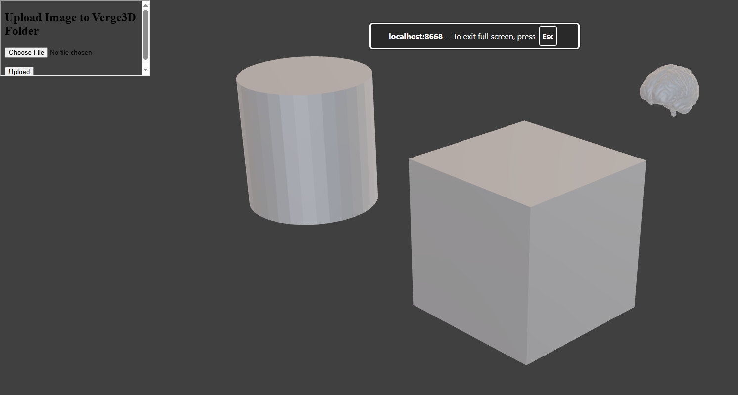

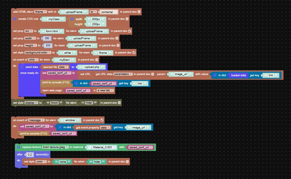

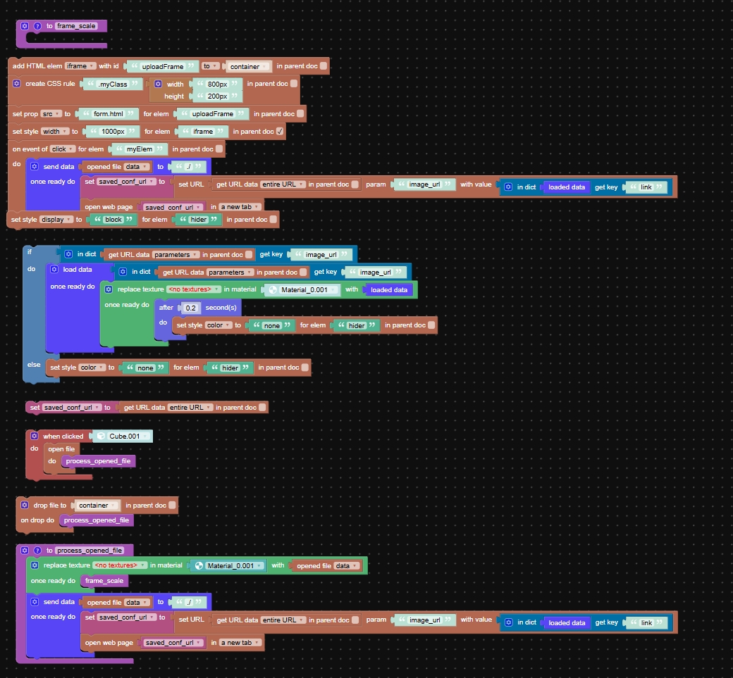

    I am trying to upload an texture image through verge3D HTML forms and PHP in my current directory but the image is not getting uploaded. What could be the issue?
    #86726
    Hard to say without knowing the server specifics? Do you have some custom PHP form processing code there or maybe Verge3D for WordPress plugin?
    Also, check out the print to console puzzle. It can help a lot with debugging your Puzzles scenario.

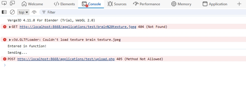

    I have tried to upload the image file into directory using Verge3D, but it gives 405 error. Why does this happen and how can we resolve it?
    #86869
    It appears your custom PHP form does not accept POST requests which is required for “send data” processing.
