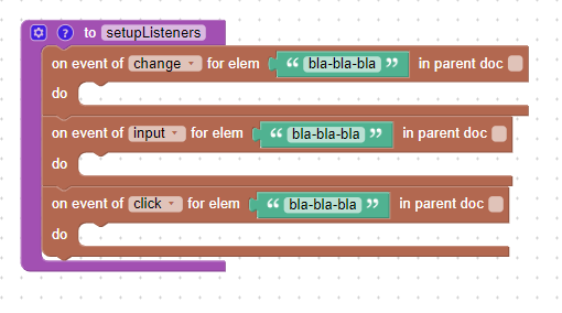

    So, I’d recommend to make a procedure in puzzles for registering all event listeners that you need, something like that:
    – and now you need to call that procedure programmatically from the detectFormReset() function:

    A little remark: it would be better to change
    parent.$(content).on('remove', detectFormReset);
    to something like this:
    parent.$(content).on('remove', function() { setTimeout(detectFormReset, 10); });
    – just to wait a little bit after the original HTML element was removed, because the new one can be not available immediately.
