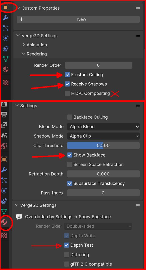

    I am working on a flame animation but the frustrating thing is the flame is seen on top even when it is behind. what settings am I missing?
    check video
    I tried all possible settings in material & order-independent transparency. But nothing works.

    If HIDPI is on for that object it will render over the top…may want to check that.

    #81824
    visualizer
    HDPI didnt work I tried possibly all combinations.
    Some times it is essential to just take break & restart the system.
    At last could find out the combinations which fixed the frustrating thing.
    Sharing here.
    Apart from this if anything else works; dont know.
    #81828
    Yeap, it initially looked like Depth Test was disabled )))
