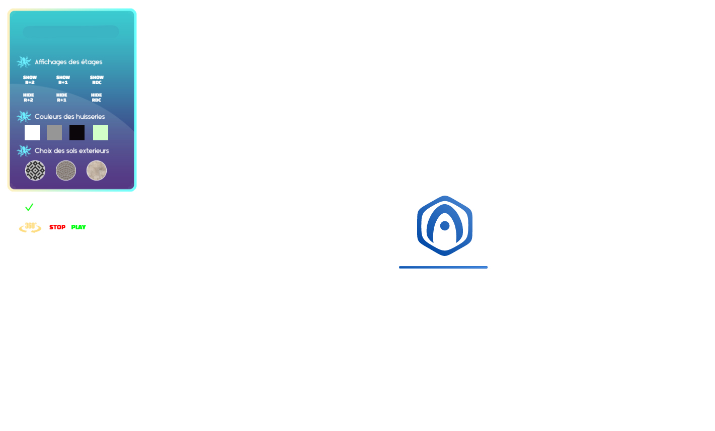

    i have a little problem when my scene is loading, i have my interface at the same time as my scene loads, i would like to show interface when loading is finish.
    how it’s possible with puzzle ?

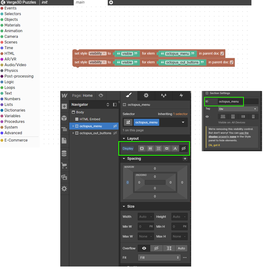

    thank you for you answer, but nothing of my ui appear after load, i do screenshots, maybe i forgot something in puzzle ?
    thank you yuri :)
    #36835
    in your case you should try setting display to block
    #36872
    christophe60
    thank you it works !! :heart:
