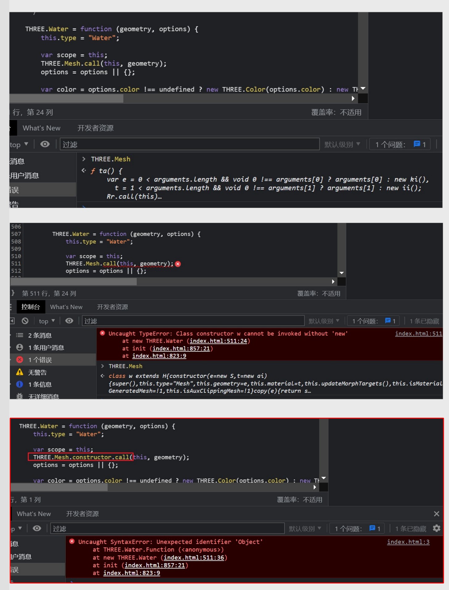

    Before v3d 4.0 v3d.Mesh is a function,After 4 v3d.Mesh is a Es6 class,
    Resulting in an error when calling the code,Screenshots of the correct and incorrect code are provided,What’s the solution? Please help
    #55784
    Hi, indeed, you have to make a class-based Water object now. See example here.

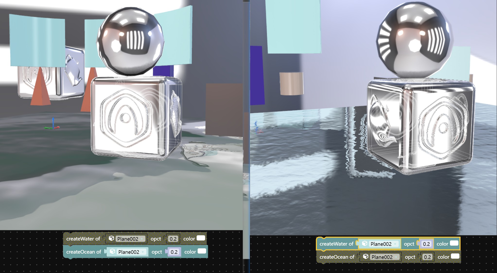

    #55798
    aqiang
    Thanks for your help. I made a plug-in based on the new demo, but there are still errors in the reflection of the water surface. I don’t know how to improve it
