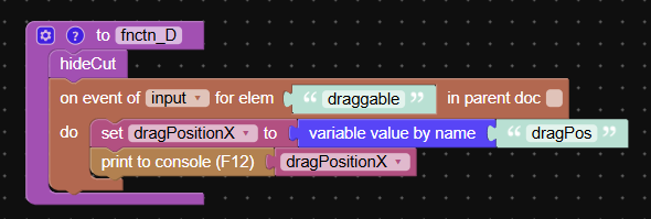

    I have a variable puzzle “dragPositionX” who’s value should be ui.position.left. I set dragPositionX to dragPos .
    puzzle
    The console logs Relative X but does not log the value for dragPositionX.

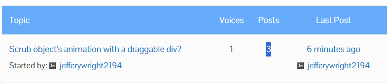

    This forum is not displaying what I submit.
    There is something wrong, there should be 3 posts as seen in this view.
    3
    But here in the post, there is only two?
    2

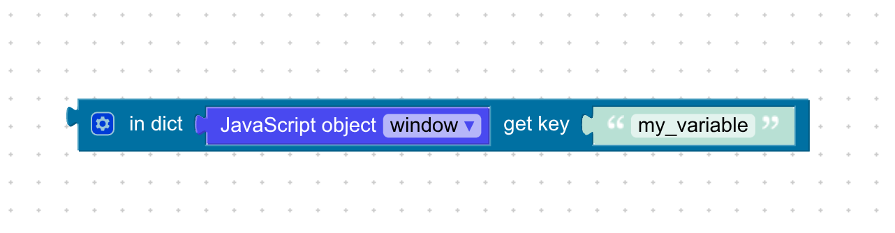

    “variable value by name” works only for the variables defined in Puzzles. To retrieve a JavaScript variable assign it to the “window” object (to make it global) and then use the “javascript object → window” puzzle to retrieve it. See the example:
    An alternative approach would using API calls or message passing as described here.

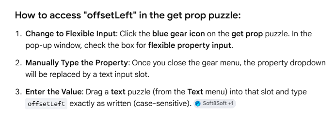

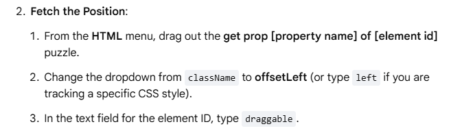

    Thanks, I am using Google AI to create a detailed, step by step process to achieve the outcome I want, but it has posted this issue:
    If the get prop puzzle in your version of Verge3D lacks a gear icon, it is because you are using a version where “flexible input” is not enabled via a menu. Instead, you must use a specific combination of puzzles to “force” a manual property entry.

    What version of Verge3D has a blue gear icon on get prop?
    • This reply was modified 5 months ago by jefferywright2194. Reason: This forum has no preview function or simple add image function
    #87159
    Unfortunately none. The entire answer looks like an AI hallucination. I’d suggest going with the global variable approach.

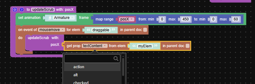

    ChatGPT did far better, this procedure worked, see the attached document. I don’t fully understand it, I never ever would have figured this out on my own and it seems like no one has done this before, as I can find no examples of this anywhere.
    This might make a good app template to include for users to access in the manager someday.
    Procedure: Verge3D 4.10.0 + JQuery Drag Div to Scrub Object Animation
