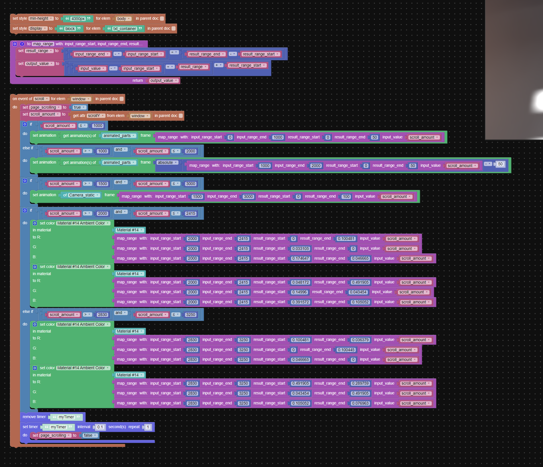

    sirhc
    Hi Guy’s
    Looked into the Scroll for 3ds Max version.
    So here’s my attempt. Completely setup form 3ds max.
    All code is the same & max file camera works also.
    Linked materials in puzzle work (not tweaked thou, just working)
    Scene rendering also works & scroll not on text also.(extra div)
    Two Questions:
    -Fonts work but I dont understand how…??
    -How did you do the Background blue effect???
    https://cdn.soft8soft.com/AROAJSY2GOEHMOFUVPIOE:ac6e684bfe/applications/my_awesome_knife/my_awesome_knife.html
    Greetz Chris :bye:

    #34031
    It’s connected insive css file.
    Not sure that it’s possible to reproduce using 3ds max shader system.
